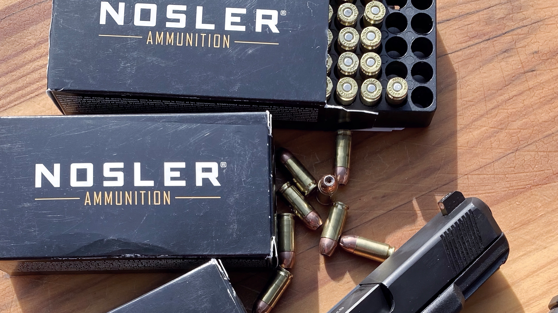

Nosler 115 Grain ASP 9mm Cartridges
I tested Nosler’s 115 grain ASP 9mm cartridges, a controlled expansion cartridge designed for defensive use. The advanced design of the ASP bullet prevailed in these tests.

We shoot our test cartridges at 20 yards. This was quite an endeavThe cartridges burned cleanly, without excessive flash or smoke. Nosler uses standard brass with their own headstamp, and they fed and ejected smoothly.
