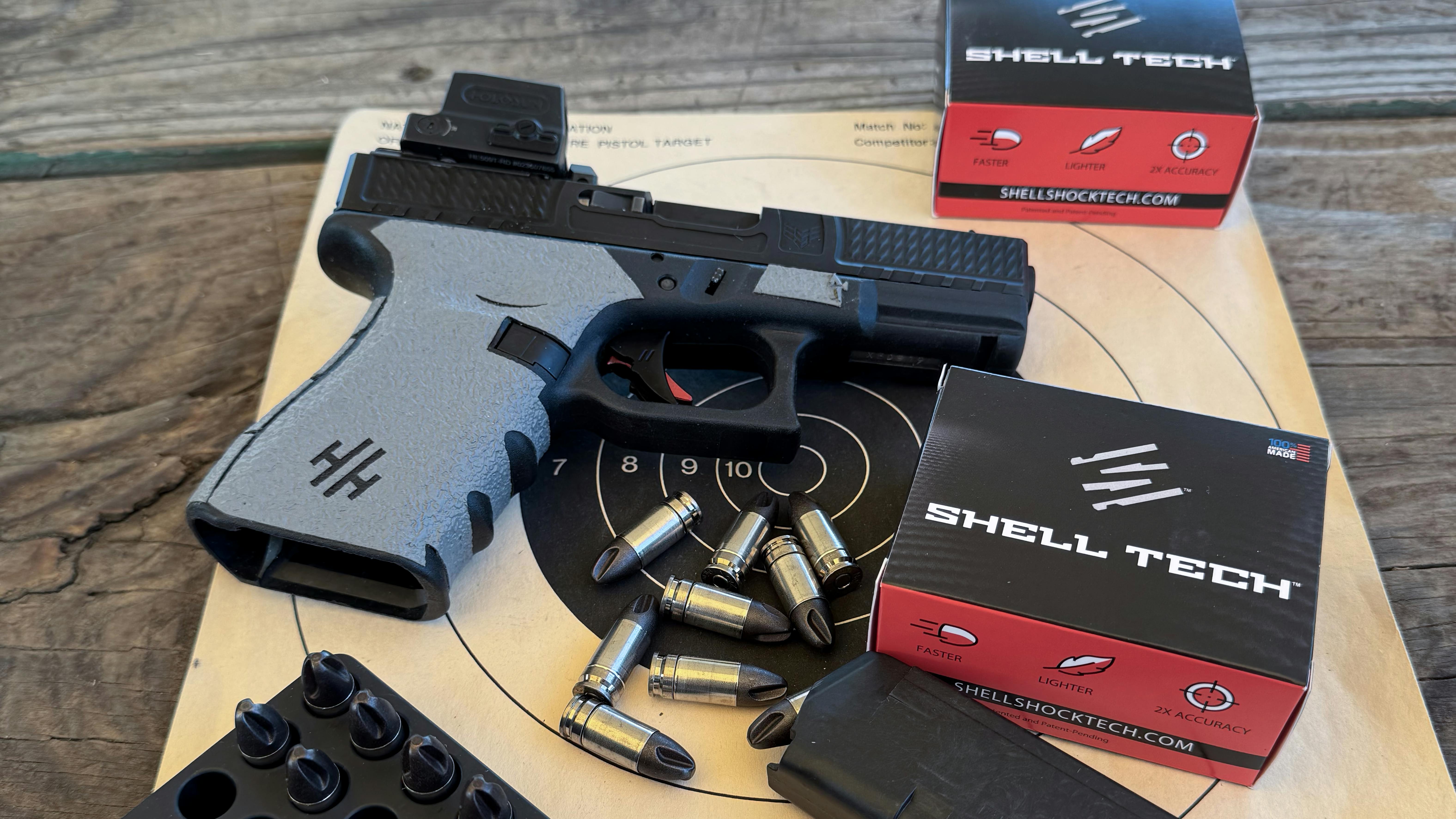

There is a trend towards lightweight and non-lead bullets in the field of ballistics. The 9mm cartridges have 65 grain bullets are an injection molded copper-polymer mix. This is extremely light. In order to be effective at all, a lightweight bullet has to be driven at blazing velocities. SST specs this cartridge at 1650 fps. In my Glock 19, it averaged 1605 fps, which is amazingly fast.
Shell Shock Technologies is a company that first started out making high volume 9mm cases and quickly expanded to rifle and military rounds. The brass design uses unique engineering, and the cartridges made from this brass behave with a completely different set of rules.
When I said “this style” of SST cartridge, bear this in mind. The SST copper polymer cartridges are good for a particular application. SST has another 9mm available, which is a 124 grain ASP bullet, loaded into the SST cases. The Nosler ASP bullet is a proven performer, and this is a good duty round choice. The SST copper polymer cartridges I tested here have a completely different set of qualities.
Instead of brass, Shell Shock Technologies uses a nickel silver alloy, designated as NAS3. The NAS3 case actually is formed from two components, a NAS3 cylinder, and the base, which is connected to the cylinder by the flash hole, which acts as a rivet to seal the components together. The pistol brass uses an aluminum base. SST rifle brass has a stainless steel base.
The Shell Tech cases look and fit like brass, but their properties are completely different, given the tensile strength of the case, light weight, and slick exterior. Unlike brass, the NAS3 cases expand when the cartridge is fired, but they return to nearly their original dimensions quickly. Brass forms to the chamber when it is fired, and stays that way. Because of this, brass gives more resistance when it is extracted from the chamber. The smoothness of the slide movement is noticeable when shooting cartridges of NAS3.
NAS3 cases can generally handle higher pressures than brass cases, and some cases also have a little more burning chamber capacity. The potential for higher velocities and greater performance exists. What I found during testing was consistent with this premise.

I weighed 3 SST 65 grain cartridges: 311.0 grains. I compared this with 124 grain conventional cartridges: 567.7 grains.
To put this in perspective, 15 rounds of standard duty ammo weighs 2838.5 grains, compared to 1555 grains of SST ammo. If an Officer is carrying two magazines off duty, that’s 5.86 oz difference. This could be the difference between deep concealment and a sloping beltline. I generally carry a 15 oz 9mm, so that’s a lot.

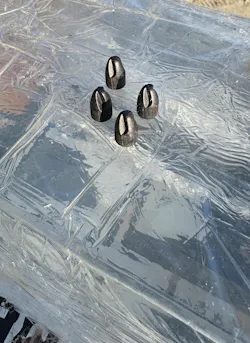

The injection molded bullets have engineered grooves in the nose that displace tissue in a manner that creates maximum wound channel trauma. It is a manner of controlled tumbling, and the design manages to penetrate consistently within the FBI Standard. I ran the SST bullets into bare gelatin, and the average penetration was 14 inches. In fact, the variance only went from 13.5” to 14.5”.
The SST 9mm rounds delivered pretty good numbers. 9mm ammo can run from 250-390 ft lbs in energy. These ran around 385 ft lbs in my tests. Foot pounds are calculated by velocity and mass. The SST rounds do well because they sent these light bullets at incredible velocity for a 9mm.
In bare gelatin, the bullets didn’t expand or deform at all. In fact, when I recovered them, they looked like they could be loaded back into the cartridge.

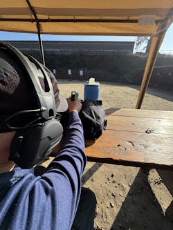

I fired the SST cartridges for accuracy, and it was not hard to shoot a 2.5” group at 20 yards. They were very consistent in my two different Glocks and my SIG. SST brought on completely different shooting patterns though. First, they felt as if they ejected the spent brass faster. I have no good tools for measuring this, except the fact that the brass was thrown 10 feet behind the shooter when using my Glock 19. This is consistent with the properties of the NAS3 case, which does not balloon like brass. There is very little resistance from the extracted case.
Although the recoil impulse was only average, there was a lot of muzzle flash and it was a little louder than a standard weight cartridge.
