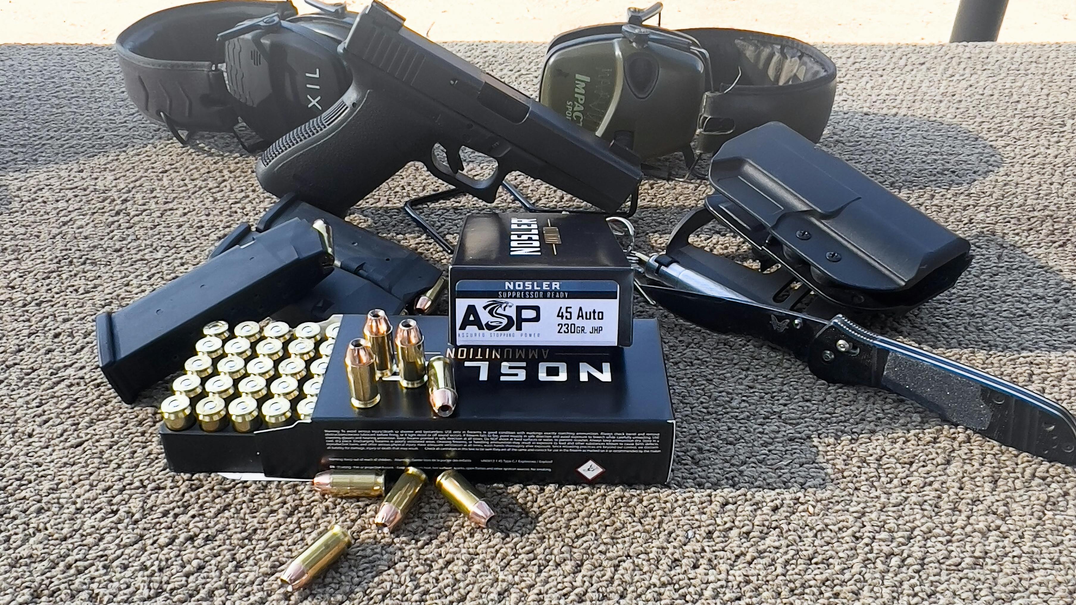

I tested two of Nosler’s 45 Auto cartridges; a 230 grain ASP (Assured Stopping Power) and a 185 grain ASP. I liked the performance of both, but I liked one better. Which one? Let’s look at the data.
The cartridges I tested are from their ASP, Assured Stopping Power, line. The ASP bullet has several features desirable in defensive cartridges. The ASP is a hollow point bullet whose jacket surrounds the lead in the center. The bullet nose is a truncated cone, which is known for reliable feeding. The jacket has pre-scored skives, which control the expansion, giving it consistent performance.

We used a Glock 21 to test the cartridges. Cartridge performance varies from gun to gun, so I always recommend that agencies test them in their duty guns before making an adoption decision.

When I fired the 185 grain ASP bullets across my Caldwell chronograph, they averaged 975 fps, which is very close to their advertised velocity. Since velocity is a critical factor in cartridge effectiveness, this was a very good start to my testing.
Nosler specs the 230 grain cartridge at 850 fps. The ones I tested averaged a little over 750 fps. I thought this was going to be a dealbreaker, until I started shooting these bullets into blocks of Clear Ballistics gelatin. They performed. In bare gelatin, the bullets averaged 15”. Except for the one that I sent sailing through the bottom of the block, the bullets expanded nicely, retaining 100% of their weight.
In the clothing portion of the test, where the bullet is into the gel block fired through 4 layers of denim, the 230 grain bullet averaged 16.5”. One of the bullets went 20.5”. When I inspected it, the hollow point was filled with denim fibers. It expanded only a small percentage.
Through windshield glass, the 230 grain bullets travelled an average of 14.5”. One factor we like to see is consistent performance in a cartridge when the bullets are fired through various materials. The Nosler ASP 230 grain cartridge had this consistency.
The 185 grain bullets averaged 12” in bare gelatin. They opened up consistently to about 150%. The also produced one of the most unusual results I have ever had: During one round of testing, all of the bullets fired into gelatin ended up within an inch of each other. I was able to dig through a single hole in the gelatin to draw them out.
Most One of the bullets shed one of the skives. It was exactly at the bullet’s place of rest, so this jacket/core separation was not alarming. The skive was sharp enough to cut one’s hand. Ask me how I know.
Through windshield glass, the 185 AS bullets came to rest at 11.5”. One of the bullets had a slight separation, right where it stopped.
The Nosler 230 ASP cartridge performed as expected. The 185 grain cartridge did most things well, but not with the efficiency of the 230 grain one.
I fired the cartridges for accuracy. It was not hard to print sub 4” groups, even with the fliers in my groups. I can promise that the gun and cartridge combination shot better than I can.
