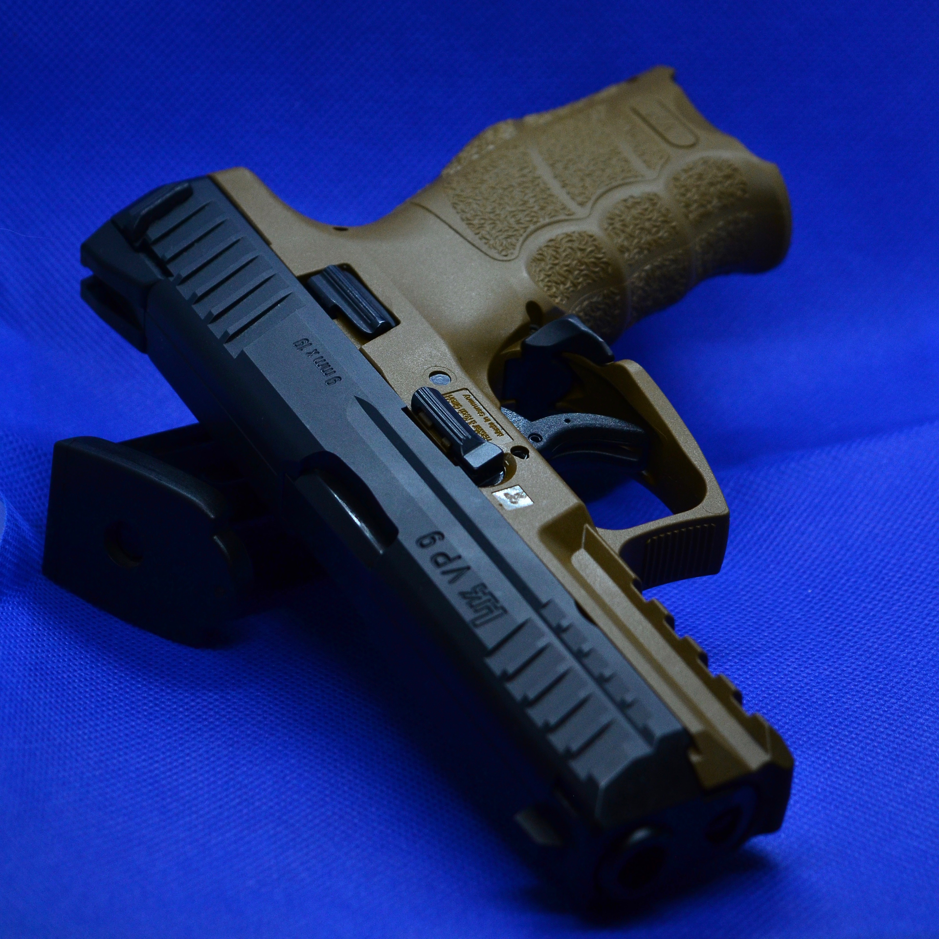

The VP9 uses a reinforced polymer frame, which is undercut deeply where the web of the hand rides. There is a growing market for users to get their polymer guns stippled—a professionally-done one feels amazing. One of the more common customizations is to undercut the trigger guard, which provides relief for the middle finger. The VP9 has this undercut.
The VP9 also has enough trigger guard room for gloved fingers, a characteristic consistent in all of their products. It balances well in the hand, and the grip surfaces are pronounced enough that the user is able to index their master grip quickly and consistently.
The VP9 is so customizable that there is pushbutton magazine release version, which allows the user to switch the side on which it actuates. Wait, let me back up. Most Heckler & Koch handgun models use an ambidextrous magazine release that is a lever below the trigger guard. Pushing either side down pops the magazine. It is simple, and very intuitive, which is probably why they use it. Eeverything is ambidextrous on the VP9. The left side of the gun has a standard slide release, which just about any sized hand can find intuitively. The right side has a low-profile slide release, which is almost a seamless experience for left handed officers.

The VP9 uses polygonal rifling, which is generally more efficient than traditional rifling. Traditional rifling uses distinct lands and grooves to impart the bullet spin. The cross section of polygonal rifling is more like a twisted polygon moving down the barrel. The design tends to seal the gases behind the projectile and deliver increased velocities.
My experience with polygonal rifling has demonstrated that this makes a difference. Side-by-side, a polygonal rifled gun will yield higher velocities and are generally more accurate. Heckler & Koch uses a cold hammer forged barrel. Their manufacturing process for barrels is well known for longevity and accuracy.
The VP9 can be quickly field stripped. This task is similar to most other combat guns. One checks to see if the chamber is clear and the magazine has been removed. Then check it again. Rotate the takedown lever and ride the slide forward, pulling the trigger to the rear.
The difference between the VP9 and my Glocks is the tightness between the frame and slide assembly. It actually took a little working back and forth to separate the parts. This is not a bad thing, but a demonstration of the level of precision of Heckler & Koch products.
The VP9 is about as robust of a handgun that one can find in the field of combat tools. There are, however, some things about it that make me want to carry spare parts. First, the VP9 does have a drop safety, but it does not resemble ones that typically reside in striker-fired firearms. Most of them are simple plungers, where the plunger is pressed when the trigger is pulled all the way to the rear. The plunger has a block that prevents the forward movement of the striker. On the VP9, there is a rotating cam. This accomplishes the same task, but it uses an axle and a spring.
The same goes for the trigger bar spring. The one in the VP9 is a long, twisted assembly that rides in a pocket inside the frame. This spring is almost twice as long as springs from similar types of guns. Here’s the rule: the longer an exposed spring, the more likely it could get caught on something. Although it might have added some engineering challenges, I would have completely enclosed the fire control system in some sort of sub frame.
Heckler & Koch uses hardened roll pins in high wear areas. The magazines have steel bodies with slick interiors, progressive springs, and seamless welds. The magazines dropped free from the gun and we let them hit the ground during our shooting session.
