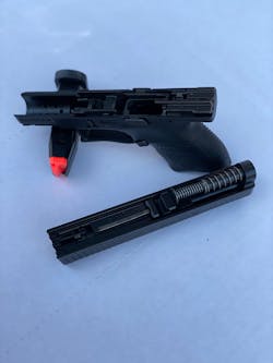

The slide itself is a piece of outstanding engineering. First, anyone who claims the P10 series is a “copy of” or “resembles” a similar looking striker-fired pistol, they are completely wrong. The internal design barely resembles most other guns. In a CZ P10 model, I tell skeptics, “Ok, show me the disconnector on this gun.” Anyone born into the Glock generation will have some difficulty here, so I try to be gentle.

Rick Macchia, my gunsmith friend, and I were looking at the engagement angles of the striker and trigger surface. The trigger bar appears to drop off the striker at a slight angle, which appears to allow a very short window of contact when pressing the trigger. This gave the P-10’s trigger an unusual crispness and light take up. It’s not a target trigger, but it is on the top of the food chain for combat guns.
