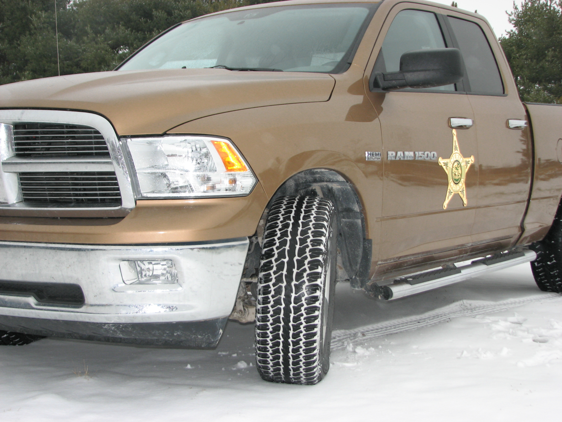

We verified Tire Rack’s objective, all-terrain versus all-season test results with our own subjective, long-term driving impressions using one of our RAM 1500 SSV trucks. The patrol jurisdiction is very rural with 52 percent paved roads and 48 percent gravel-stone roads. Most calls for service go to population centers with paved roads, but deputies still log 25 percent of the time on gravel stone. Those percentages favor an all-terrain tire.
We replaced the worn-out OE tires and put 10,000 miles on a set of Firestone all-terrain tires for a wet fall season and half of the snowy winter. We then installed a set of Firestone all-season tires for another 10,000 miles for the rest of the winter and the early wet spring.
Among the brands of replacement tires typically purchased by police fleet managers, one of the highest rated all-season tires is the Firestone Destination LE 2. Of the 32 different all-season tires sold by Tire Rack, the Destination LE 2 ranks sixth overall. Of the frequently purchased brands, one of the highest rated all-terrain tires is the Firestone Destination A/T. Of the 17 different all-terrain tires, the Destination A/T ranks third overall.
Under dry conditions, we had very few ABS-activated stops and wheel-spinning starts. We did, however, corner at close to the limit with both tires. We found the dry performance to be a toss-up. There was more tire noise and a harsher ride with the all-terrain tires, but Noise, Vibration and Harshness (NVH) are not a big deal in a police truck.
We found the wet performance of the all-season tires to be better than the all-terrain tires. When driving in 2WD, unintended wheel spin with the all-terrain tire was an issue. The ABS activated more often with the all-terrain tires under heavy braking while turning. The all-season tires felt much more responsive during hard cornering in the wet. In the wet, slushy snow, packed snow and deep snow drifts we expected differences between the tires, but it was another toss-up. In the deepest snow, and on snow-covered gravel, the all-terrain tires did slightly better than the all-season tires. In wet snow, packed snow and on snow-covered pavement, the all-season tires did slightly better.
