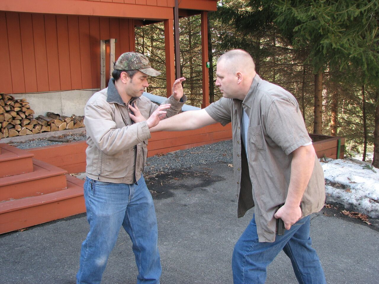

So what’s the solution? What’s a better technique? I first saw the answer in an article by Gary Klugiewicz in the November/December 2000 issue of The Law Enforcement Trainer (the publication of the now-defunct American Society of Law Enforcement Trainers.) To ease you into it, think of what we’ve all been trained to do with long gun to empty-hand transitions. Slung or not, we lower and control the shotgun or rifle with our support hand and use our strong hand for empty-hand maneuvers (or to draw a handgun.) Well, the same exact principle applies to the handgun. We simply withdraw our dominant hand from the handgun, leaving the handgun in the support hand, and inherently in a position in which no matter how hard we squeeze, the gun cannot be fired, and use our strong hand for whatever empty hand tactics are called for. The accompanying photos illustrate this.
This technique has everything going for it: It's fast, it's instinctive (with minimal training), and it has commonality with long gun training. Oh, and it's safe: safe for the suspect, and more important, safe for innocents, including fellow officers on the scene (and the scene of a flying bullet is a mile or so!).
