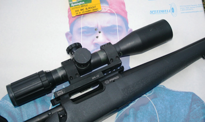

For my testing I decided to zero the rifle at a practical range of fifty yards. This is no long range sniper set up by any stretch of the imagination. The optic I chose was a fixed 10x rifle scope with Mil-Dot reticle. Using the sub-sonic Remington load I fired a number of test patterns to see what kind on consistency I could expect. Fifty yard, three-shot groups were averaging in the half to one inch range. All shots were taken with the SureFire suppressor in place.
Shooters used to a twelve plus pound .308 sniper platforms may find the light-weight gun a bit frustrating. You’ll definitely notice more movement in your crosshairs than with your $3000 heavy-weight custom bolt rifle. However, we go back again to the fact that we aren’t taking thousand yard shots with the Micro 7.
