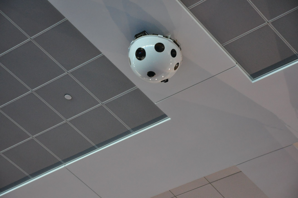

There's a smart camera like that at Logan International Airport right now, bolted to the ceiling of Terminal A.

The new video security surveillance system, named Imaging System for Immersive Surveillance, or ISIS, was conceived at the Lincoln Laboratory at the Massachusetts Institute of Technology and launched by the Pacific Northwest National Laboratory for the Department of Homeland Security's Science and Technology Directorate. The version installed at Logan, called Spiral 1, sees the entire concourse like a large fisheye lens, but that's where the similarity with most conventional surveillance systems ends.
This cutting edge technology is years ahead of the current commercial offerings, according to PNNL.
Whereas a typical fisheye lens distorts the image and can only provide limited resolution, ISIS video is perfectly detailed, from edge-to-edge. That's because the video is made from a series of individual cameras stitched into a single, live view, like a high-res video quilt.
"Wide-area views generated by typical closed-circuit television systems are often chopped up into different monitors, so the security professional has to look a bunch a different screens to get overall perspective," said PNNL's Doug MacDonald, ISIS project manager. "With ISIS, everything is now displayed on one large monitor."
Coverage this sweeping, with detail this fine, requires an extremely high pixel count. ISIS has a resolution capability of 100 megapixels. That's as detailed as 50 full-HDTV movies playing at once, with optical detail to spare. ISIS also has a zooming capability for getting up close and personal without losing clarity.
Each operator works independently with their own monitor and have access to any part of the 360-degree coverage. Further, each operator can review realtime video or access archive video taken moments or days before without affecting the operational performance of the system. Operators are able to use monitors at their desks, typically 24" flat-screens, but at the same time have access to clear, high resolution video never before provided. ISIS can see clearly up to 160 yards away.
When officials need to identify a suspect from among the throngs of passengers mulling about the airport, ISIS provides a clear enough image that operation of the entire terminal would not have to be interrupted.
