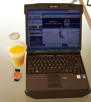

Now before I get much into the info about the General Dynamics Itronix VR-2 laptop computer I want to be clear about this: there a number of major manufacturers of "ruggedized" computer equipment who are no doubt interested in having a review of their product done. I have asked several for a T&E sample to "abuse" prior to writing it up I was told (paraphrased) "no way". Hmmm... So, you want me to write a review of your equipment but you're not confident enough of its capabilities to let me beat it up THE WAY YOU SAY USERS CAN before I write it? Alrighty then. But not General Dynamics. Prior to testing I enjoyed a phone converation and interview with them and made it abundantly clear that I intended to do what they told me I could. Their response? "That's fine." That first picture at the top shows you just how ugly things are about to get.
The second picture shows it getting ugly. The rep from General Dynamics told me that I could pour any non-corrosive liquid into the keyboard - up to 12.6 ounces (because at that point it runs out over the edges) and let it sit for up to ten minutes before rinsing it out with warm water. As you can see, I picked something that can be fairly sticky - even after only ten minutes: Orange Juice. Just for the record, that's pulp free not from concentrate Simply Orange orange juice - about ten ounces of it. As you can see, I wasn't shy about pouring it into the keyboard.
The watch on the table, although not visible in clear detail in the photo, was included to keep track of time. Although General Dynamics said ten minutes I decided to go only five. I felt that was abusive enough. Additionally, once the time was passed I was told I could use warm water to rinse the thing out. So, not only did General Dynamics "man up" but they told me I could pour that liquid into it, rinse it out, and drop it all I wanted from a height up to 30 inches.
