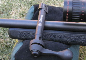

     The floating bolt head that closes the chamber door was another feature that stood out. Floating lugs are the same size as locking lugs but rotate freely behind them. Floating lugs ensure a completely concentric feed and keep the assembly stable in the boltway. The floating bolt aids in a more consistent cartridge placement in the chamber, minimizing the headspace, or measurement of "play" in the chamber variance.
     Bullets fed off the detachable box magazine easily. We did not have any problems extracting and ejecting any of the hundreds of rounds fired through it. With the magazine attached, the rifle could also be single-loaded and safety checked in the dark by any tester who had previously seen the rifle in the light. We especially liked the thumb operated three position safety, which was also small-hands friendly.
     Custom gunsmiths spend many hours getting the bolt to bear evenly on all sides when chambering the cartridge. Although many factors influence accuracy, centering the cartridge the same way every time will distinguish the purebred from the mutt. The action on the 10FCP appears relatively easy to manufacture. However, our long shooting sessions required us to inspect and tighten parts on the bolt regularly. The extractor was strong and easily removed for service or cleaning. In fact, the entire bolt was user serviceable and easy to disassemble.
