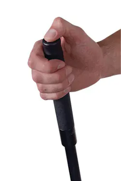

If you have never heard of ASP, you must be living in a hole. ASP in my opinion is best known for their Friction Loc batons. Keeping with their tradition of fine batons, ASP has introduced their steel Talon Disc Loc Baton in 16, 21, and 26 inches. Unlike the Friction Loc batons from ASP, the Talon has a large easy to use button on the grip end that when depressed allows you to manually close the baton with one hand. This means that you no longer need to slam it on the ground to collapse it. When extended, the baton uses opposing discs to lock the baton in to position. You may remember that the Friction Loc would collapse unintentionally sometimes. This happened to me a few times during civil disturbance call outs in aMarylandcollege town known to get a bit rowdy after big wins.

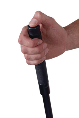

That won’t happen with the Talon. Extension is smooth and lock up is positive. There is a slight bit of muffled rattle in the baton when extended but, when collapsed, there is absolutely no rattle at all making it completely silent. Extending the baton hasn’t changed but you get one more option for opening the Talon. It can be opened manually by pulling the tip of the long end. This can come in handy if you are in a tight space like a hallway or near other people who might be injured if you use the normal method of extending it toward the ground or up. On the 21 inch Talon I was provided, the balance point was approximately 8 ¾” from the grip end of the baton. This puts the majority of the weight in the grip area. The foamed vinyl portion of the grip end measures just short of 6 ¾” and is very comfortable in the hand. The foamed vinyl grip also helps in reducing shock and vibration felt in the users hand during a strike.
