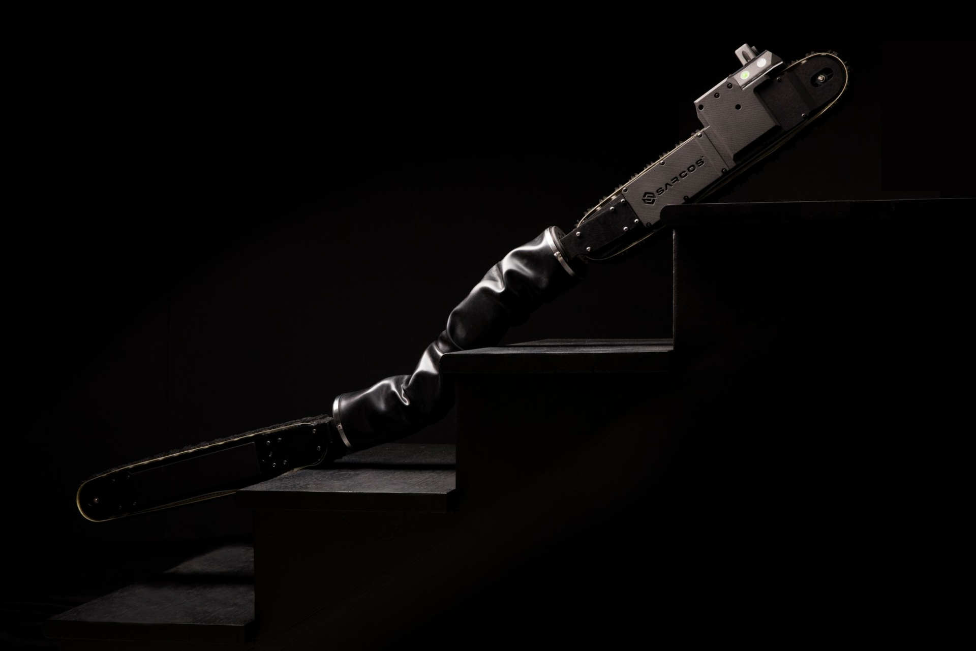

Sarcos directed their efforts towards the other end of the spectrum with the Guaridan S. "The S is a very small man portable inspection robot," says Wolff. Without an arm, the robot was not meant for manipulation but for surveillance and enhancing situational awareness.
The S runs about 13 pounds. "We're building this robot to put [it] very easily in a backpack or even slung over your shoulder," Wolff explains. That light weight puts the S in a class of a number of small robots, but also with limited capabilities. Once you start going away from the traditional two-treaded robotic tank design stairs, water, and payload become obstacles. Sarcos, however, designed the Guardian S in three sections. The rear holds the battery; the center is a sleeved collar with a series of motors, transmissions and actuators; the front is meant for carrying sensors and cameras. A optional mounted platform will allow the S to carry extra cargo.
It also comes with an option to add Picatinny rails to mount wanted sensors, should additional detail be needed. However, the standard sensors do cover a large range: four multiplexed cameras for a 360-degree view, night vision capability, LED illumination, GPS, IMU, accelerometer, magnetometer, a FLIR 320 x 256 camera, and a rear facing camera to aid navigation. Need more? Use the Picatinny rail or add sensors to the two included sensor bays.

At 4.2 inches wide by 5.25 inches high, the Guardian S was designed to fit through small narrow openings. Law enforcement should be able to drive the robot into place, set it into surveillance mode and send audio and video – silently – back to the operator. However, it seems the S wasn't meant for covert missions. "It's not a stealth robot," says Wolff. "It is no louder than any other law enforcement robot that's out there – it emits no noise at all when it is in place and doing surveillance."
But isn't it the getting the robot into place the trick? More covert throwable robots don't have the size to reach higher ground. Yet, other tank-like robots don't exactly fit through air ducts or piping. The motors in the middle section allow the Guardian S to lift up and traverse stairs (at 45-degrees) easily. Sarcos also reports its ability to navigate gravel, sand, dirt, concrete, carpet, and curbs.
The S also includes a magnetic version for vertical travel on applicable surfaces. While the traditional model can travel at 3 to 3.5 mph, they slowed this down to 1.25 mph for more user control. "It can climb vertically or even inverted. We tamp down the speed of that version because you don't want to launch the robot from whatever surface it's on," explains Wolff. Unfortunately this functionality isn't plug-n-play; it's one or the other. Magnetic tracks are built in before shipping.
