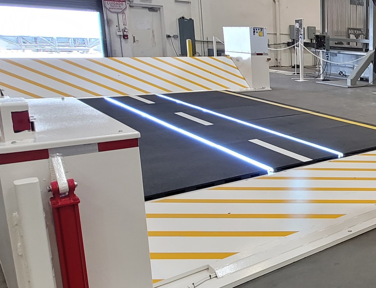

The UVLS100 Under Vehicle Inspection Light System from DELTA Scientific is provided as a permanently installed, resin-encased, LED lighting system for use as in-ground up lighting within vehicle traffic lanes to assist with undercarriage inspections. Components provided conform with the technical specifications by the U.S. Department of State. 120 degree output LED lighting delivers 654 LUX of illumination with a color temperature of 6500 Deg K. A High / Low selectable switch allows for different illumination levels.

Application Notes
  • Light beams are to be placed with 31-1/2” center-to-center spacing between the two lighting strips.
  • Use only manufacturer recommended, outdoor rated, self-leveling sealant.
  • Place underground and above grade conduit prior to installation of lighting system.
