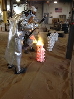

John Dapkins, owner of Jersey Tactical Corp. (JTC) had experience breaching a door or two having been on a SWAT team in New Jersey. When tools would break they’d contact the company and inform them of the problem. The typical response, he says, was “Oh, we’ll send you a new one.” Jokingly he casually says, “We don’t want another one, we want one that doesn’t break.”
They designed their Claw for a novice, or any patrol officer to be able to act without having to have had a lengthy training session. That, and with the intention of making a “tradesman’s tool,” something to last. The swing resembles an axe or sledge hammer—hold the handle at the end to maximize the physics involved. There’s a nine-pound head counter-bored onto a non-conductive handle made of a proprietary material, allowing it to flex and release energy before wrecking your hands. “Everything serves a purpose,” says Dapkins. He and his partner took four years getting the head’s angles right to create the correct leverages and points—that’s 1,000s of hours on 1,000s of real doors.
They formulated a custom mixture of over four alloys for the Claw’s head. It takes their foundry three weeks to pour to be ready for assembly.

John Dapkins, owner of Jersey Tactical Corp. (JTC) had experience with breaching a door or two having been on a SWAT team in New Jersey. When tools would break they’d contact the company and inform them of the problem. The typical response, he says, was “Oh, we’ll send you a new one.” Jokingly he casually says, “We don’t want another one, we want one that doesn’t break.”
They designed their Claw for a novice, or any patrol officer to be able to act without having to have had a lengthy training session. That and an intention to make a “tradesman’s tool,” something to last. The swing resembles an axe or sledge hammer—hold the handle at the end to maximize the physics involved. There’s a nine pound head counter-bored onto a non-conductive handle made of a proprietary material allowing it to flex and release energy before wrecking your hands. “Everything serves a purpose,” says Dapkins. He and his partner took four years getting the head’s angles right to create the correct leverages and points—that’s 1,000s of hours on 1,000s of real doors.

John Dapkins, owner of Jersey Tactical Corp. (JTC) had experience with breaching a door or two having been on a SWAT team in New Jersey. When tools would break they'd contact the company and inform them of the problem. The typical response, says Dapkins, was "Oh, we'll send you a new one." Casually, he says "We don't want another one, we want one that doesn't break."
They designed their Claw for a novice, or any patrol officer to be able to act without having to have had a lengthy training session. That and an intention to make a "tradesman's tool," something to last. The swing resembles an axe or sledge hammer -- hold the handle at the end to maximize the physics involved. There's a nine pound head counter-bored onto a non-conductive handle made of a proprietary material allowing it to flex and release energy before wrecking your hands. The head itself includes compound angles and teeth. "Everything serves a purpose," says Dapkins. He and his partner took four years getting the angles just right to create the correct leverages and points. In that time, 1,000s of hours on 1,000s of real doors.
They formulated a custom mixture of over four alloys for the Claw's head. It takes their foundry three weeks to send it to JTC for assembly. There the handle undergoes a sprial-grind and an epoxy resin is set into the threads -- this epoxy takes 24 hours to set. Clearly JTC has no intent in rushing the production process.
