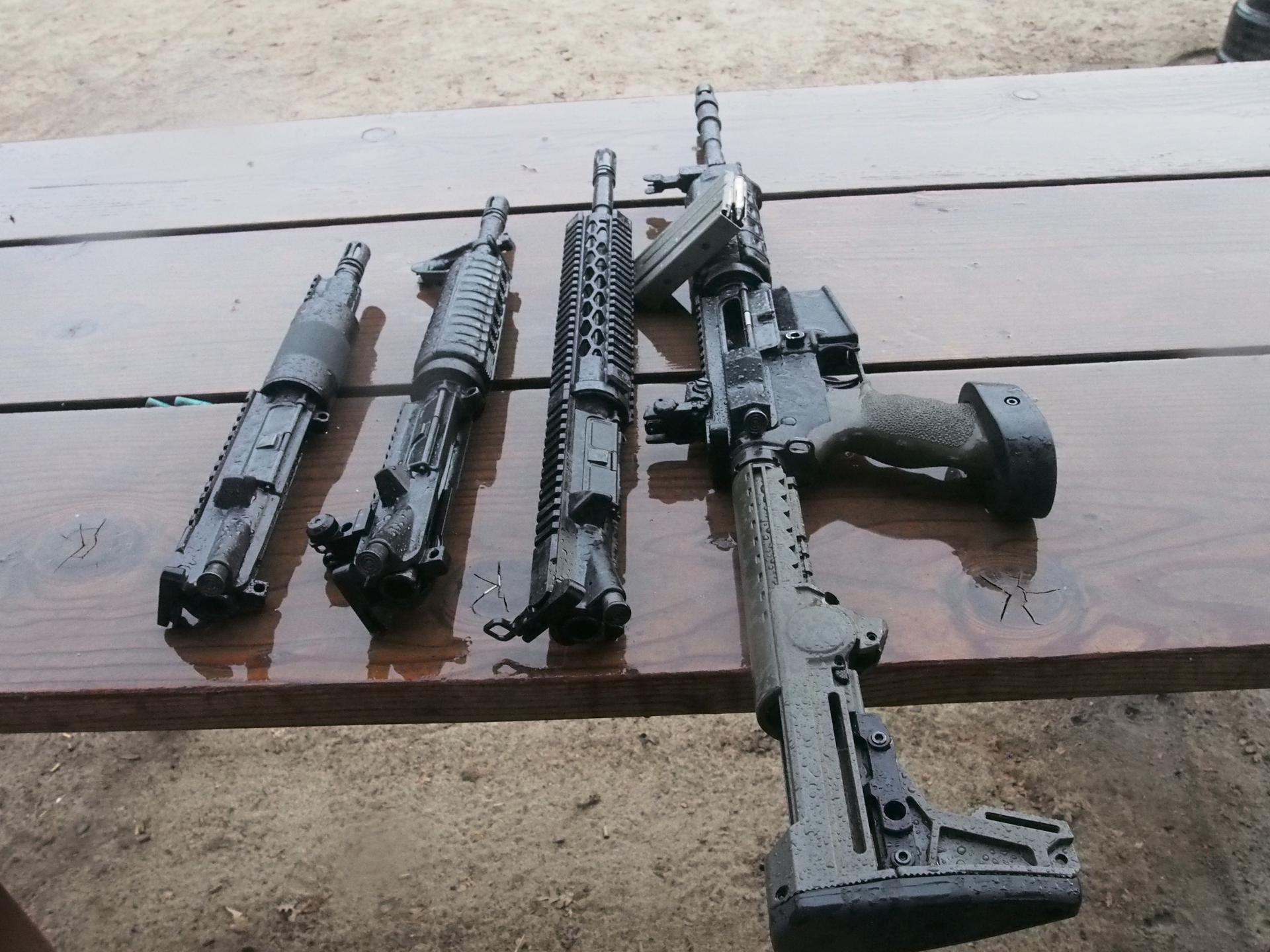

For this test, I used Franklin Armory uppers. I’ve been shooting a Franklin Armory carbine for several years. It is one of their 7075-T6 billet lowers in black Hard Coat III. Their Libertas SBR, a similar model, comes with an Ergo Ambi Sure Grip, but mine has an Ergo Tactical Deluxe Grip with Palm Shelf and F93 Pro Stock. Franklin Armory is a manufacturer based in Morgan Hill, Calif. Although they can field large departmental orders, each is made by hand using components made in the USA. Franklin Armory has a growing law enforcement market, and they can tailor their product to the needs of a specific requirement or task.
I used complete Franklin Armory uppers in 7.5 inches, 11 inches, 14 inches and 16 inches. They use a salt bath nitride finish in their steel, including the chambers. Their aluminum parts are Hard Coat Type III and most uppers are free floated and vented. First I chronographed them, then I shot them in ballistic gelatin.
