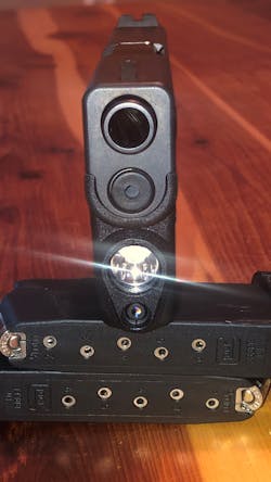

The “standard” TLR-6 comes with a white light unit and a red laser unit. It runs on two CR1/3N lithium batteries. Streamlight’s published information about the unit specifies that the light unit delivers 100 lumens that will run for one hour on full batteries. My test unit lasted a bit longer than that with no observable dimming of the delivered light for roughly 80 minutes. My test unit also had the red laser incorporated which is specified as a 640 to 660 nm red laser.
The laser unit is adjustable for both windage and elevation. The necessary VERY SMALL Allen wrench is provided with the unit and I suggest you be very careful when opening the package. I dropped the one that came with mine and spent some time looking for it. Oh, and don’t lose it or throw it away after you’ve zeroed your unit. There are several reasons why you might need to adjust the zero in the future from changing weapons to changing zero distance. Put it in a safe place.
The unit itself can be turned on in one of three modes, each predetermined by the setting you leave it in. The default setting on it when I received the test unit was to have both the light and the laser on. The light is turned on by touch pressure on the activation button on either side of the unit (it’s fully ambidextrous). While the unit is on, pushing BOTH buttons will change modes. You have your choice of light and laser or just light or just laser. Once you have it in the mode you desire, turn it off. When you turn it back on, it will come back on in the mode you had set before turning it off.

The published paperwork says the unit is made from durable impact-resistant polymer, IPX4 water-resistant, and is one-meter impact resistance tested. After dropping the light (attached to my unloaded, clear, and safe G43) five times from a height of 3.5 feet (just over a meter) onto the deck at the range, I reloaded and tested the weapon/light configuration. The laser was still zeroed and the light worked without issue (although it and the gun were a bit banged up).
