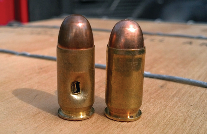

During the last couple of months I’ve personally found pieces of factory fresh ammunition that were damaged in the manufacturing process but shipped out. About two months ago I discovered one round of .45 ACP that had a hole punched in the case wall and the propellant powder had all fallen out. A week ago as I write this, I encountered a piece of .45 ACP that had the projectile seated too deeply causing the case wall to bulge ever so slightly. This round would not fully chamber.

First and foremost, if you are loading your personal defense firearm with ammunition you will potentially be using to save your life, I would visually inspect every piece. Taking each round and dropping it in the chamber is solid advice as well. If you really want to get serious, use a digital grain scale and weigh each and every round. If you find a round that is a few grains off that might indicate a low or empty charge.
