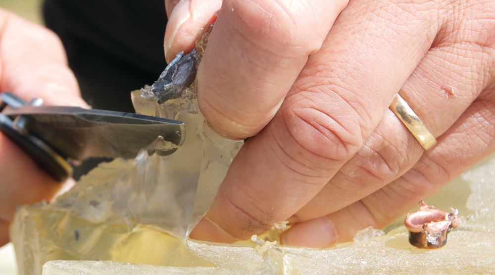

The past two months I have been attacked repeatedly by blocks of ballistic gelatin and so far, I have prevailed. My friends find this behavior eccentric. I get huge tubs of ballistic/ordinance gelatin in powdered form from VYSE, and prepare large blocks of material. I shoot these blocks and record the data. If readers walk away from anything valuable in this article, the lesson should be: Try this at home!

I abbreviate my testing to the bare gelatin and automobile glass test. I purchase real auto glass and prop sheets of it in front of the prepared 10 percent gelatin. I can usually get several shots through a sheet of glass and about three shots into a gelatin block. I am looking for expansion and penetration. If I am testing a single cartridge, I shoot heavy layers of clothing also. I would personally like to do much more testing, but my refrigerator only holds three blocks at any given time.
Here's what you want your cartridge to do: It should penetrate ballistic material from 12-18 inches and expand between 1.5 to 1.75 times its initial diameter, retaining its full weight at its final resting point. It should be able to penetrate intermediate barriers like auto glass and still be “effective”. Handgun cartridges should be able to print about 4 inches or less at 25 yards, which is most often better than the average shooter can shoot. Since my accuracy testing relies on my own eyes, which are subject to all kinds of factors, this portion is pass/fail. For example, several of the groups I shot with Winchester's .357 SIG were single holes at 25 yards, with a flyer that opened up the group. When I was putting it down on paper, it was 3.75 inches, but some groups could have been <1-inch without the flyer.

I have added a table of preliminary results. Bear in mind, that these results should be integrated in the overall results of many tests, in order to establish trends. I encourage agencies and individual officers to run their own tests. Most importantly, I encourage officers to adhere to the three rules in cartridge performance:
