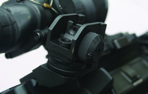

Now that we’ve accepted the offset issue, let’s consider some solutions. The simplest and easiest to use is the CSAT Rear Sight Aperture from XS Sights.   The CSAT rear sight aperture replaces the standard aperture found on most A2 rear sight housings.   Designed by Paul Howe, retired MSGT US Army, Special Operations, the CSAT rear sight compensates for bore offset and allows the officer to use their AR sights like standard pistol sights.   No mental gymnastics or calculating under stress.
The next solution to offset for a rifle with magnified optics is to mount a set of canted sights at 45 degrees left or right of the optic. Dueck Defense offers a set of iron offset sights with AR front and rear hardware.   To mount this sight option you’ll need a Picatinny top rail on the front and rear of your rifle.
LMT and Predator Tactical offer platforms that allow you to mount a mini red-dot of some sort at 45 degrees. This takes the mini red-dot from a 5 inch offset down to a more manageable 1 to 2 inches. Naturally, the mini red-dots are windage and elevation adjustable allowing you to BZO your close in optic for practical distances of 10, 15, 20 yards, etc.
