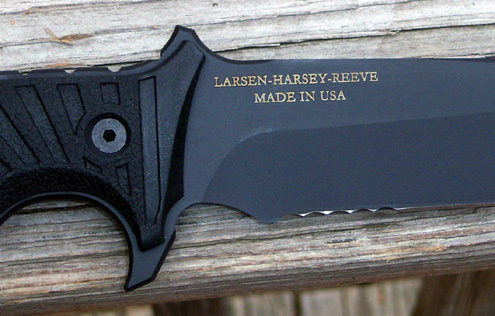

Anyone who has seen Harseys's or Reeve's work before will recognize some of their handiwork. The ergonomically shaped handle and the steady curve of the back of the grip that merges into the spine of the blade with a smoothness only interrupted by the hint of an angled hilt looks familiar. The ridges that are milled into the back of the handle along that hilt offer good traction for your thumb if you need to press into a cut. The choil deep enough and curved just right to put your index finger into if your technique demands it is something we've seen on Harsey and Reeve designs before. The lanyard hole integrated into a "skull crusher" pommel are also familiar.
Sporting a blade that's just shy of 7" and incorporating about 1" of serrations near the choil / hilt, this knife was obviously designed for combat use. It would serve equally well as a general purpose field knife, although a 7" blade isn't something you normally require for general field use. The grips are made out of something Gerber refers to as "TacHide" and it feels like stiff rubber. The grip slabs are molded to swell in your palm and have ridges molded in for added "traction" as well. The Gerber page about the LHR mentions that it was specifically designed to be easy to hold onto even under wet conditions - and testing held this out. Thanks to the shape of the handle and the molding of the grip slabs, it was easy to hold onto this knife... even when I coated it with motor oil. But that's what I had to do to make it even start to feel slippery. Water didn't affect grip at all... neither did sweat (I didn't try blood).
