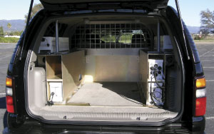

     Radiation detection devices called Adaptable Radiation Area Monitors, or ARAM, developed at California's Lawrence Livermore National Laboratory (LLNL), are mounted in the cargo areas in the back of SUVs called RadTrucks to take counterterrorism to the streets.

     The trucks come equipped with touchscreen graphic interfaces and text message pagers. Modular system electronics and an integrated Pentium-based processor are housed in weatherproof, electromagnetic and radio frequency interference shielding enclosures that can be installed in any SUV platform.
     Textron explains that ARAM uses a sodium iodide (NaI) device to detect gamma rays and a helium-3 (He-3) unit to detect neutrons. Both operate on the vehicle's 12-volt DC system. State-of-the-art signal processing allows ARAM to acquire 1,024 channels of data 10 times per second, which in turn allows higher probability of detection and provides the analytic software high-quality data for identification. The vehicles can be configured to include multiple detectors, as well as spectral data transmission and video capture. Current RadTrucks come outfitted with one or two NaI gamma detectors and up to four He-3 neutron detectors per vehicle.
