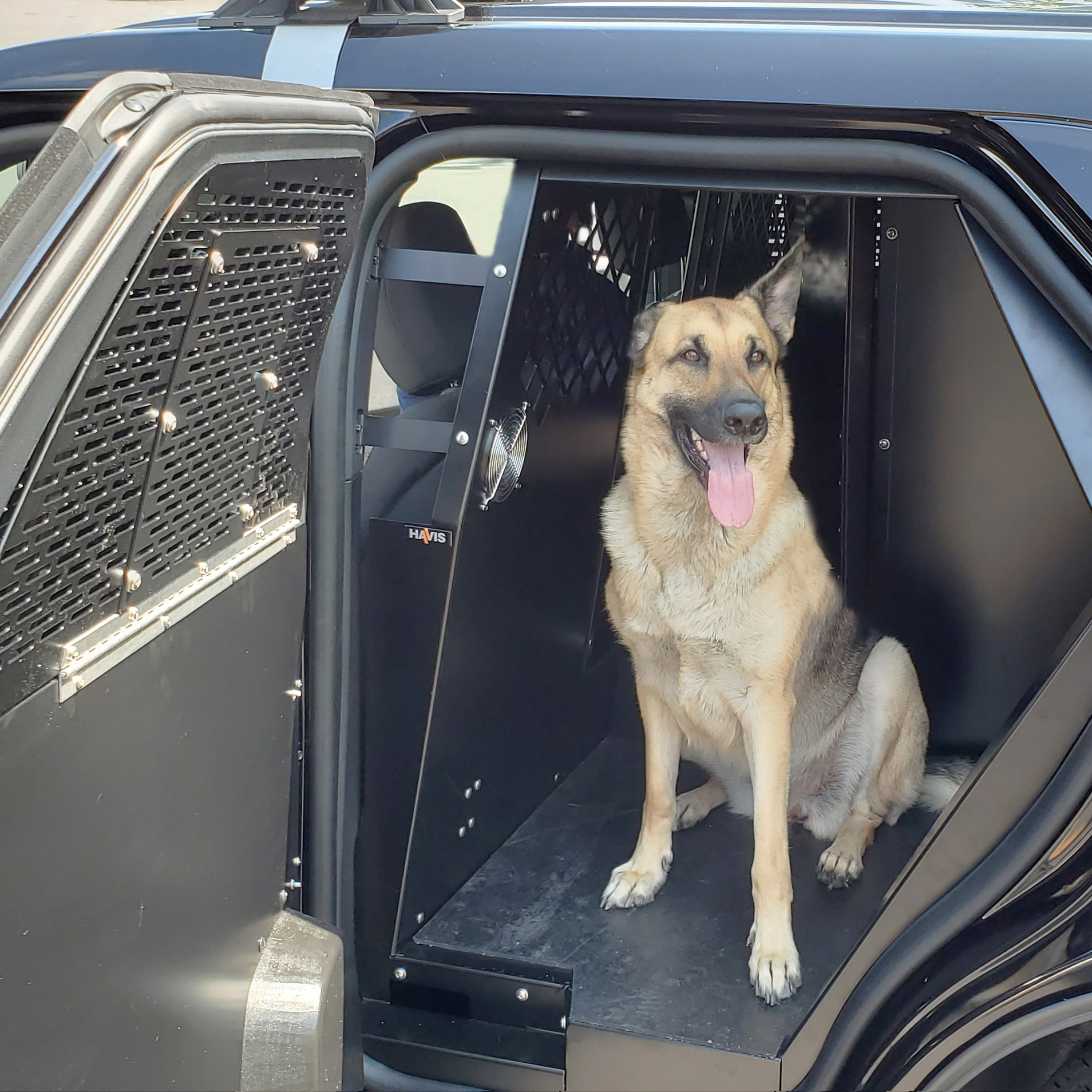

While the Trident M1 wasn’t developed for vehicle/crash protection, K-9 partners also need a specialized space for the patrol car. That’s where companies like Havis come into play. Their latest advancements include units the 2020 Ford Interceptor Utility and 2019 Chevy Tahoe. “These units provide dual dog options and more space for dogs to turn around and relax while in transport,” says Jeff Tripp, Project Manager: Fleet for Havis Inc.
The heat is a silent danger to anyone trapped in a car and the patrol vehicle is no different. Without adequate air circulation, temperatures can rise at an alarming rate. Havis K-9 units have built-in additional venting for climate control and a sliding front door for emergency access. For further K-9 safety, they recommend the “Hot N Pop” optional heat alarm.
Additional safety and accessibility improvements include an optional Dual Dog Divider with latching door featuring:
- Quick egress latch accessible from either compartment or front
- Prevents catching leash or collar
- Not accessible to chewing
- Latch design prevents rattle
The compartment allows a 50/50 or 60/40 split to allow different sized dogs, prisoner transport or to adapt to your storage requirements
Also exclusively available for the 2020 Interceptor Utility are aluminum door panels with fold-down window guards. The design includes an over-molded speaker cover to retain your original door construction and well as cut and formed to fit with mounting holes—this aids in making installation and cleaning easier.
