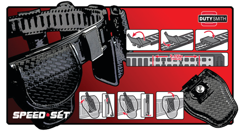

I remember, "back in the day," when I asked my sergeant how come we don't refer to our gunbelts as "bat belts," because it seemed like we carried as much stuff (if not more) than Batman. He jokingly replied that on Batman's belt, the stuff went on and came off a lot easier. That was true in the late '80s; also in the '90s; it's no longer true today thanks to Duty Smith and their new SpeedSet gunbelt system. Bear in mind as you read this review that I had an early prototype to test (and it performed well), but the design has been upgraded since then. The pictures almost explain how everything works better than words can.

The "heart and soul" of the SpeedSet duty belt is best described as, "an end-to-end light weight rail system." About a year ago I was talking with a representative from BLACKHAWK Products Group, wondering why they hadn't put there CQC system to work in a similar fashion. For whatever reason, they chose not to pursue it, but Duty Smith as with a vengeance. The belt is made from a flexible composite material overlayed with a metal rail system that is only slightly less flexible. The buckle is the smallest I've seen in the industry but locks down tight while leaving extra room in front for equipment.

Many officers are familiar with the flip-lever mounting system used by LaRue tactical to quickly mount and dismount items from any picatinny rail. Duty Smith uses a similar concept to mount (or dismount) their accessories to the metal rail system that runs the full length of the outer belt surface. Not only does this allow you to quickly reconfigure your belt but it also enables you to do it without having to take the belt off. Currently, their line of accessories, available in plain black or basketweave, includes a collapsible-baton holder, handcuff case, flashlight/OC Cannister pouch, gloves/key holder (enclosed), and a radio pouch. Note they do not make holsters that mount on the speed rail. I used a BLACKHAWK SERPA Level III Duty holster when I tested the SpeedSet. I had no trouble mounting it and, quite honestly, I'd not trust my life to a holster that was lever-mounted on a rail.
With that thought in mind, I felt I needed to test how hard (or easy) it would be to "rip" any of the accessory pouches off the duty belt. I was provided a full belt and accessory set, so I put it all together, mounted my holster and started my testing.
To test the strength of the mounting system, I put the belt on, attached it to my pants belt with four snap-on keepers, and then proceeded to try to push each item down away from me with both hands. In doing this I was stressing the top-mounted lever-lock that secures each pouch to the rail. I was not able to push any of the pouches off, although I did flex the metal rail some.
Next I wanted to test the mounting system in the other direction, so I gragged each item with both hands and pulled the bottom of each one up as hard as I could, trying to peal it away from my body, up and off the belt. Again, no luck.
Satisfied that I wasn't going to be able to "break" it, I wore it for several days at the range, putting it on before leaving the house - as if I was going out on patrol - and not removing it until my "duty day" was complete (at least eight hours). At the completion of the wear testing I had experienced no malfunctions or failures in expectd performance. The belt was as comfortable to wear as my nylon duty belt (if not more so) and although I'm sure there is a measurable weight difference, albeit very slight, I didn't feel it during the wear test period.
