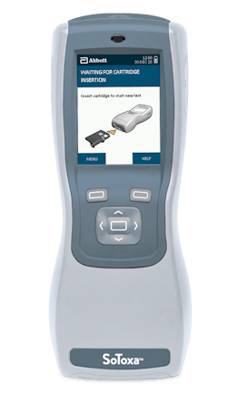

In a similar product, Abbott—a global healthcare leader—have partnered with Intoximeters—a leader in breath alcohol testing known in over 90 countries worldwide, to bring the SoToxa portable system to the U.S. law enforcement market. The device “is a portable system designed for rapid screening and detection of drugs in oral fluid”. As of mid-August 2019, law enforcement agencies are able to acquire both Intoximeters’ Alco-Sensor brand breath alcohol-testing products and Abbott’s SoToxa Mobile Test System. Intoximeters is the exclusive distributor of the SoToxa instrument.
Instead of a puff of breath, this device requires a swap of the oral fluid. But alcohol can be pretty straight forward, detecting narcotics, on the other hand, can be a bit more complicated. Combating this, Abbott’s SoToxa system is able to detect six classes or drugs: amphetamine, benzodiazepines, THC, cocaine, methamphetamine, and opiates. A roadside test with easy-to-read results can be completed in five minutes. A study in Kansas recommended adding oxycodone and tramadol to the panel; work is ongoing to add those. “It’s really difficult to add drugs that come and go like spice compounds—once you get a test for one it’s a different one. So, those would be more difficult to add,” says Moore.
It’ll be little surprise if you’re familiar with the SoToxa solution; the device has been used in many countries around the world for over a decade. Spain, for example, finds its small size beneficial as their law enforcement utilizes more motorcycles for patrol than vehicles. The ability to have a device with such a small footprint is a great benefit for any law enforcement officer with an over-packed mobile office.
An officer would begin the test by collecting a sample of oral fluid from the driver and inserting the swab into the main SoToxa device. The sample is then mixed with buffers and sealed, later to be safely discarded. The device was designed to avoid any officer contamination during or after. The screen lists all three main classes of drugs and returns a positive or negative result - there is no color comparison to match, no subjective results to interpret.
Earlier this year, the Michigan State Police conducted a roadside analysis pilot program to evaluate the use of the SoToxa device. The agency was originally conducted in five different counties and given to drug recognition expert officers. The instrument was not provided to regular officers. Results were 95% of the 92 roadside tests were confirmed by an independent laboratory; 89 of which were arrested. The Michigan State Police pilot program has since moved onto phase two moving SoToxa statewide. Additionally, it also currently being evaluated by multiple states throughout the U.S.
