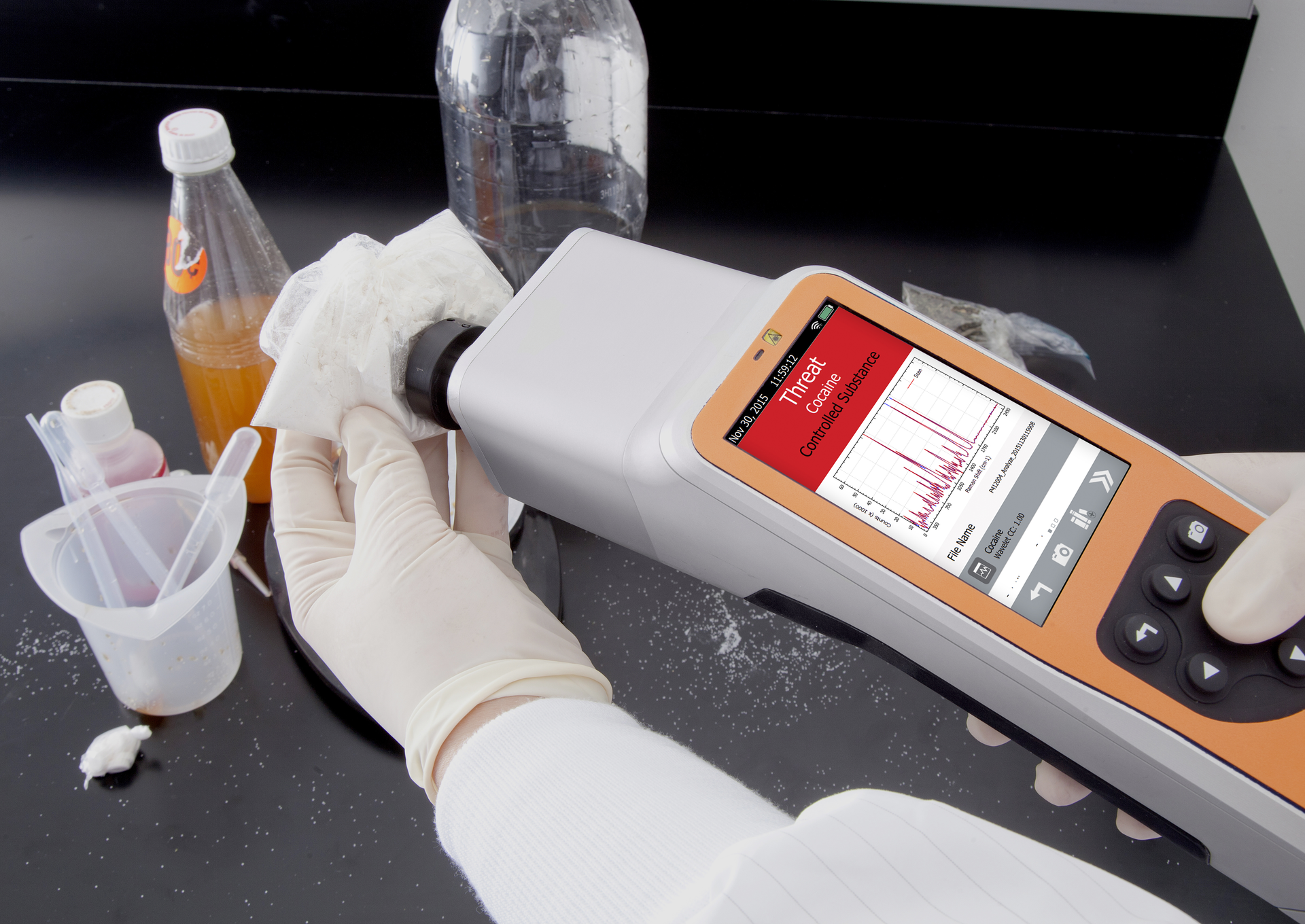

Raman spectroscopy is a confirmatory test under Category A by the Scientific Working Group for the Analysis of Seized Drugs (SWGDRUG) and is widely used to support the detection and identification of illegal substances. Raman is a highly selective technique and has the ability to differentiate between a wide range of compounds which is critical when faced with an increasingly broad range of threats. Unlike other handheld detection techniques, Raman analysis can often be performed through packaging material without disturbing the sample. This minimizes exposure to the operator and reduces the risk of sample contamination.
Most handheld Raman-based chemical detection systems in use today utilize a 532nm or 785nm laser to excite the sample, which are known to generate heavy sample fluorescence interference making analysis of colored materials extremely challenging.  For this reason, the use of handheld Raman based detection systems has historically been used primarily for identifying white powders and clear liquids, which are the least likely samples to produce fluorescence when excited with a lower excitation laser. However, many real-world samples commonly encountered by law enforcement professionals are colored by impurities from crude synthetic processes or from intentionally added pigments and dyes such as those found in household products including fuel oil and antifreeze.  The introduction of handheld Raman devices utilizing a 1064nm excitation laser overcomes this limitation, giving the user the ability to perform rapid identification for actionable results.
Protecting evidence from contamination is critical to successfully take a case to court. Handheld Raman can perform analysis through packaging materials such as polymer bags, glass bottles, flasks and vials allowing the user to screen materials by non-contact, non-destructive analysis, without needing to open containers and risk contamination. Border checkpoints are a well-known hot spot for drug smuggling and officers need access to rapid and reliable detection methods. In one case, 1064nm handheld Raman identified illegal substances through wrapping and lubricant found inside a known drug mule. This would not have been possible using other methods of detection and demonstrates the value of this technique.
The integrity of evidence is essential and a feature that has received positive feedback from end users is the integrated digital camera that enables users to easily store sample evidence for use in the courtroom. In addition, unlike many other detection technologies which require a fully trained operative to interpret complex results, the device can be used by an untrained operator who will receive the same results as a Ph.D level chemist. By allowing users to perform confirmatory analysis upon arrest and provide substantial, proven evidence, cases can proceed to court much quicker helping to reduce the backlog and increase the success rate of removing dangerous substances from circulation.
The introduction of handheld Raman devices utilizing 1064nm technology has increased the range of materials that can be identified using just one device thanks to an extensive library of over 12,000 compounds, reducing the number of complementary techniques required for successful narcotics identification. Depending on the cutting agent, 1064nm handheld Raman can identify heroin without the need for sample preparation kits within seconds and users can perform mixture analysis to identify the correct ID of the threat in the compounded material. The ability to easily add new substances to the library is another capability that has received extremely positive feedback from end users and it’s not hard to understand why. The latest drug formulations are constantly evolving and with handheld detection systems, such as Progeny ResQ’s customizable library (Rigaku), users can be confident that they have access to the widest range of materials possible.
