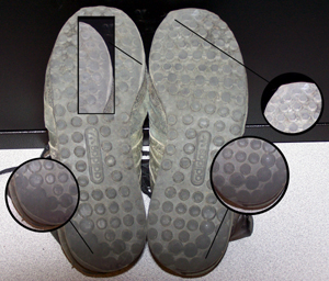

"Every individual print, every track line, is unique," I told him, "and the unique nature of footprints, or the totality of the spoor collection, is specific enough for use as physical evidence. The difference, Frank, is in the dirt!"
There are a number of ways to tell one individual from another, even when disregarding the most obvious signs of size and sole pattern. The biggest obstacle may not be locating these attributes, but in first accepting they are there and second having the confidence to find them and explain them in a TOC, at an intel debrief or on a witness stand. Speaking to military operators as much as to cops and detectives, the substantive differences between individual footprints and their interpretation taken in context, can be a critical element of establishing ground truth - whether at a crime scene or in the battlespace.

Then he knelt and indicated the bootprint. "Michael has a much less pronounced pitch angle, and in any case, you can see here [he drew a circle in the dirt around part of the print] where the heel has worn much more smoothly than Michael's. He's had two MCL surgeries on his right knee, which translates through the way he walks to a different wear pattern than would be typical of such a boot."
