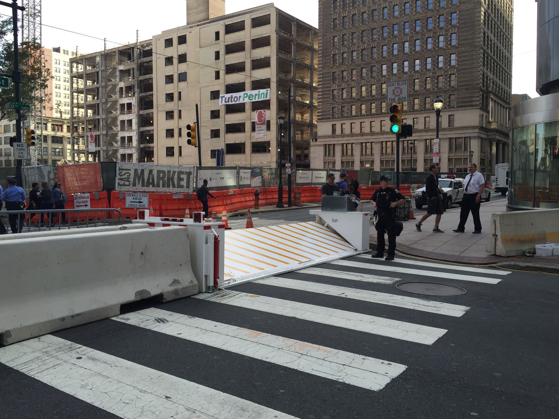

For instance, the Los Angeles Police Department purchased the units to protect its historic downtown Parker Center headquarters during times of heightened homeland security threat levels. When the homeland security threat alert rises, the LAPD's secure perimeter expands several blocks. The MP5000s can easily be mobilized in response to a threat level change, creating a safe zone at the outer areas surrounding the Parker Center headquarters. The mobile barriers are also used for special events unique to Los Angeles, such as Hollywood awards ceremonies, to provide extra security at events such as the Academy Awards, major sporting events, high-profile trials, or in the potential event of riots or natural disasters such as earthquakes.

Phl-delta 4 – To provide protection, mobile barriers are kept in the upright position
