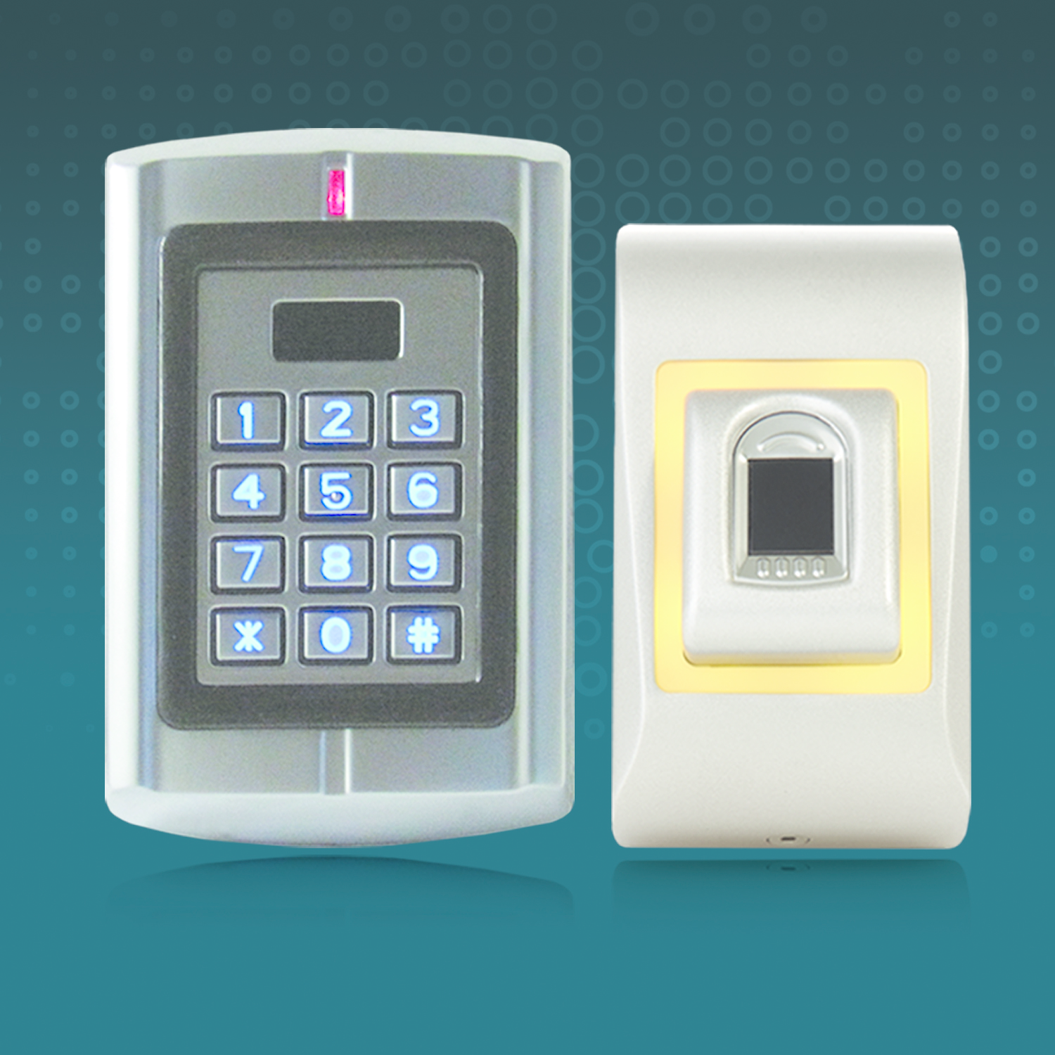

Camden Door Control's CV-550SPK is a surface mount, weather and vandal resistant, backlit, stand-alone keypad with proximity card reader.
The HID format prox reader and keypad supports up to 2,000 users with card, PIN, or card and PIN access. Rugged and attractive, the keypad/reader is designed for high traffic indoor and outdoor applications.
CV-550SPK features a cast metal housing with fully potted electronics, making CV-550SPK both weather (IP 65 rated) and vandal resistant.  CV-550SPK has inputs for REX switch/sensor, door contacts, a Form ‘C’ relay, and a tamper alarm.
The unit also has a Wiegand 26 bit input and output, which allows the CV-550SPK to operate as a dual credential (prox reader and keypad) access control system device. User cards or tags can easily be individually or batch enrolled.
