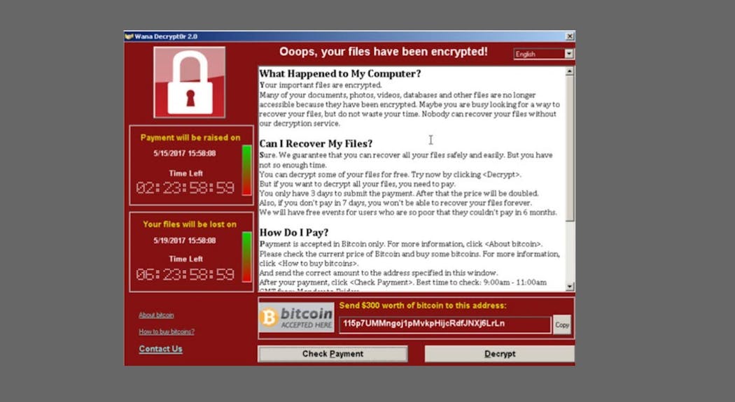

For reasons that escape me, some malicious software somehow got into the systems of various computers right around mid-May. I remember sitting here on this computer and seeing headlines flow in with this viral picture of a red pop-up screen covering up flight data in an airport terminal. As odd as it seems to think about what inspires people to cause such acts (see: "greed"), it was the type of reported victims that threw me. You see Hollywood's got it wrong. Hacking into the FBI in under a minute? No. Squirm your way into some bank system with "admin" or "12345" as the password? No. Apparently it's airports, factories, education, healthcare - to name a few - now. Again, I should not have been surprised at this list.
I'm just sad.
The software claimed to hold data for ransom - a time limit seems to tick down like a scene in "24". (I really wish there was a program named "Jack.Bauer.exe" to take it down now. That's a missed opportunity.)
