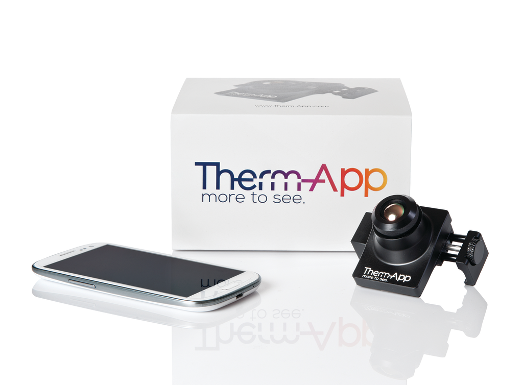

We have a digital camera already in our hands, and photos and videos are commonplace. What can be done to transcend this optic's technology? With a specialized attachement, you can now get working thermal and night vision in your hands. Opgal Optronic developed the Therm-App as such, I was sent the standard version however further upgrades are available. Therm-App needs Jelly Bean to run. Sadly my personal phone doesn't meet this requirement so I borrowed a Motorola Razr HD with the appropriate Andorid version. Note: This isn't my thoughts on the application of thermal or night vision, nor am I explaining the science behind the two.

You'll be attempted to do exactly as I: unbox and try to figure out the mouting. There's a pistol grip included the package (you'll appreciate this later) and with two USB OTG cables of different lengths. To my folly I didn't realize the different lengths at first and blindedly I grabbed one. The box also contains a "read-me" card with easy to understand instructions. I'll break them down for you: scan QR code for the free app (you can also search Google Play for "Therm-app"); mount device to phone; make sure phone is on (the card suggests this); and then connect the cord. My device asked me if I wanted it to start immediately upon connection. The grip itself is technically optional however it does make operation easier.
The mounting is as easy as that reads. The camera's back has a clamp-like grip where you tighten to hold onto the phone. You are not actually using the phone's optic, but mostly the phone's display capabilities. You're only limited to the length of the USB cord and width of your smartphone. I found mounting it as close to center provided a comfortable balance when holding the screw-in pistol grip on the bottom.
To my inital amazement and confusion the screen shown everything upside-down. I soon discovered I had installed the phone into the mount upside down. My phone might be different than yours, but I'm currently unaware of an image invertion setting. If you make the same mistake as I - disconnect and flip your device over, this is 100% user error.
While the name is "Therm-App," there's a night vision imaging mode as well. In the thermal mode, the standard version comes with rainbow, gray, and an iron color setting. Convienently you can change between these by swiping. You can access night vision through the menu. There you can also change the thermal color palate.
