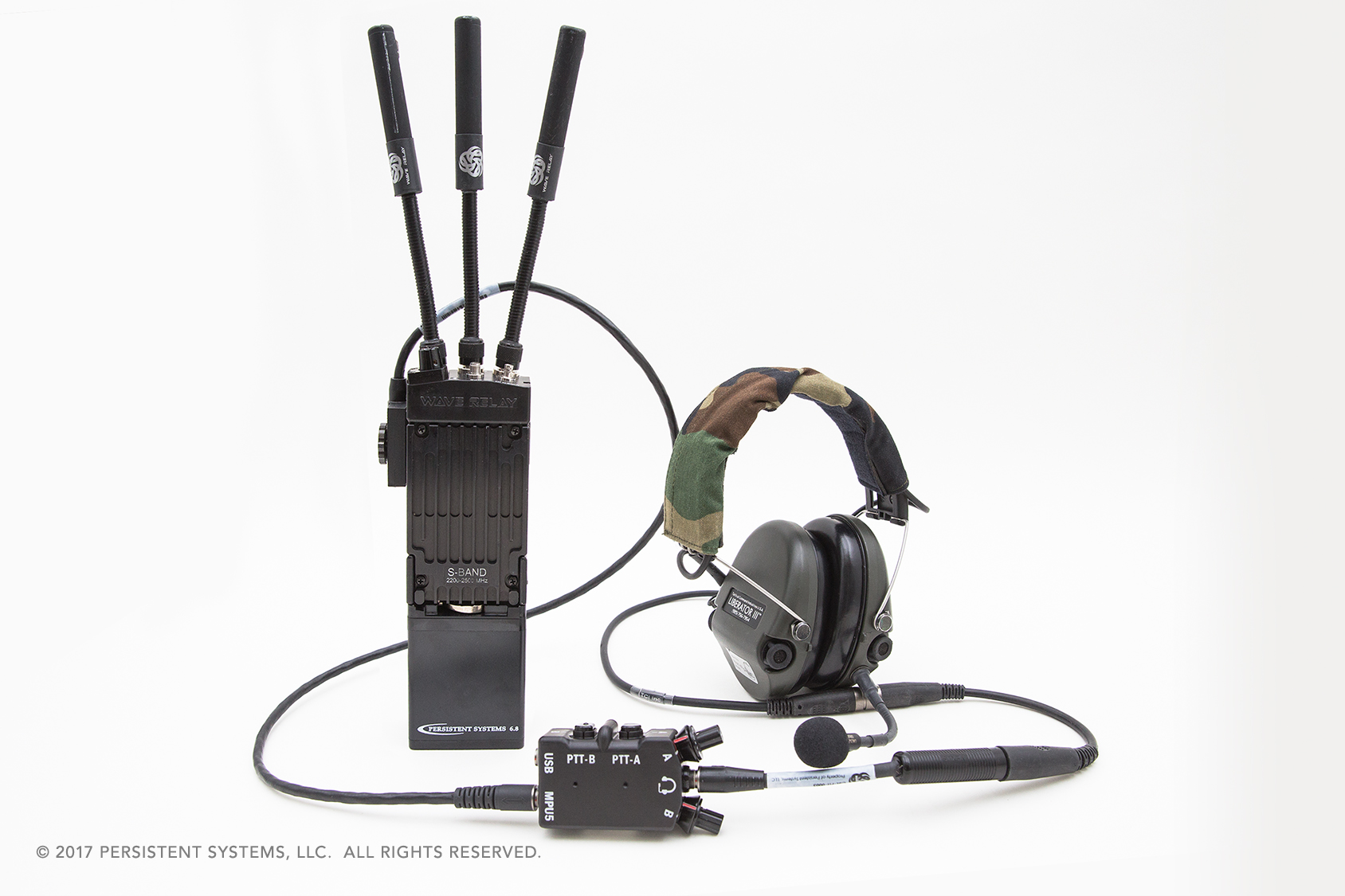

Persistent's Dual Channel Push-to-Talk ("Dual PTT") accessory for the MPU5 will allow the MPU5's audio capabilities to reach their full potential.
The Dual PTT allows the user to quickly and easily select between 16 talk groups as well as control volume levels for each talk group independently.  When paired with a stereo headset, the two selected talk groups are heard in the left and right ears, and the volume level in each ear can be controlled independently.
With the MPU5 and Dual PTT, a single MPU5 can communicate on two talk groups either independently (by pressing a single PTT button) or simultaneously (by pressing both PTT buttons). In the past, when a user needed to communicate with two different groups (channels) of users, that user needed to carry two separate Land Mobile Radios (LMRs). Therefore, the MPU5 and Dual PTT significantly reduces size, weight, power, and cost (SWaP-C) burdens on users.
This is possible because the MPU5 is an IP radio, where talk groups are multicast addresses, instead of an LMR radio, where channels are different RF frequencies.
The Dual PTT also serves as the interface into the MPU5's Radio over IP (RoIP) subsystem.  Users can tether legacy LMR radio systems to the MPU5, and associate each of those radios with one of the 16 talk groups as a multicast address on the network.  When an MPU5 user communicates on that talk group, the MPU5 "keys up" the LMR radio and transmits audio through it.
