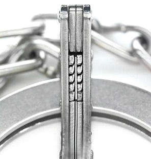

Tri-Max is CTS-Thompson's newest innovation and features bump and pick resistant technology that will to enhance officer safety during arrest and in-custody transport situations. Tri-Max Technology is available in Standard Size Chain Handcuffs, Oversize, and Extra Oversize Chain Handcuffs, Oversize Hinge Handcuffs as well as Standard Size Chain Leg Cuffs.
The Tri-Max technology consists of a dual ratchet engaging independent retaining bars separated by a barrier called Pick-Shield-XLS. Tri-Max cuffs are designed with a split-shackle construction that increases the strength of the handcuffs by directing the gap between the dual shackles to pass through a rigid monorail retaining bar. Gaining vertical and lateral strength, the internal bar also inhibits a shim from entering the nose or rear of the shackle. Independently floating retaining bars on each side of the shackle are engaged by a double five-tooth pawl. While popping the double lock may be possible, a pick has no straight line of sight to go through the handcuff to engage the rear retaining bars and depress them. Picks also don't stand a chance through the keyway.
Stamped from 1050 carbon steel, the parts are hardened from R885 to RC40 prior to assembly. This makes the Tri-Max exceptionally strong and allows maximum flexibility to avoid cracking under stress. That's why it's called TRI-MAX Security.
All Standard, Oversize, and Extra Oversize Chain Handcuffs feature Positive Clickbak loading, oversized swivel, and reinforced steel rivets for added strength, 23 locking positions and 3 independent retaining bars floating on tempered leaf spring. The Oversized Chain Handcuffs are specifically designed for larger wrists with a 6.25 inches minimum and 9 inches maximum inside perimeter. The Extra Oversize Chain Handcuffs are built for extra-large wrists and boast of an inside perimeter of 8" minimum and 10 3/4 inches maximum.
