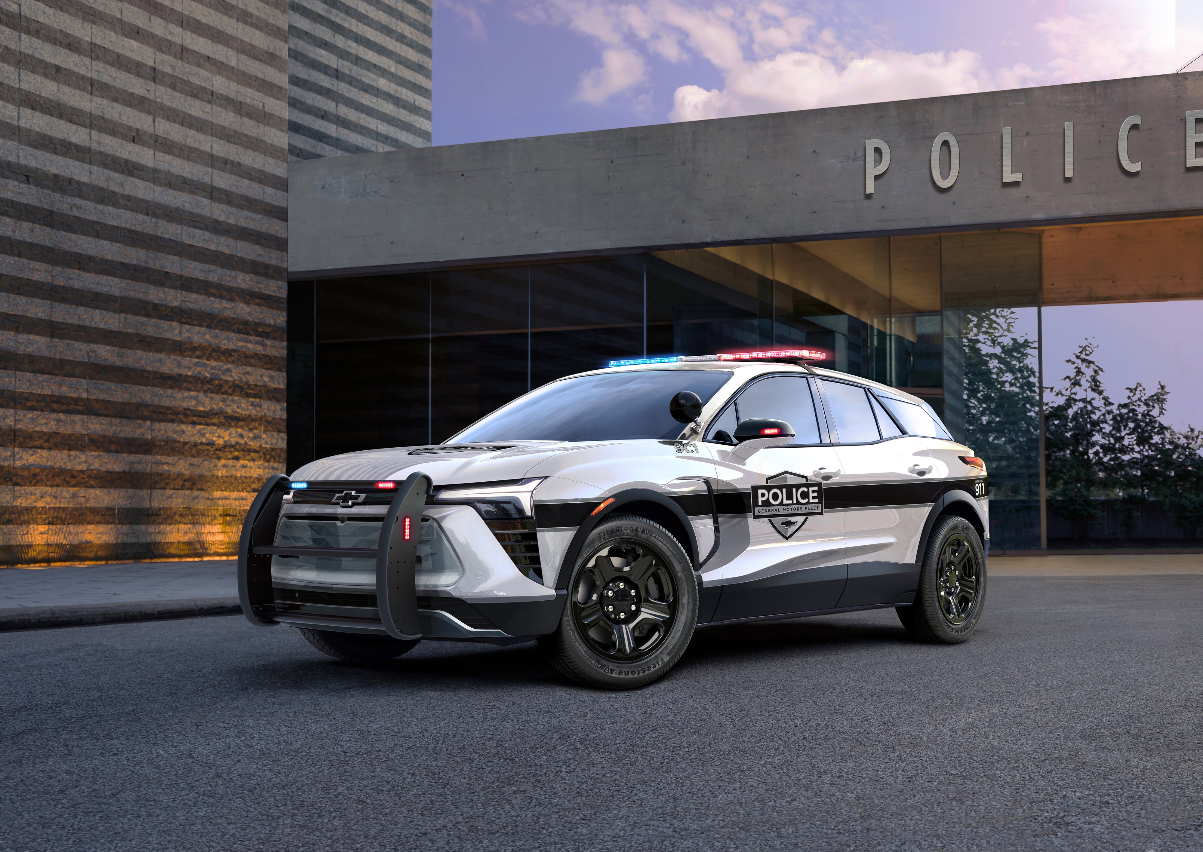

2024 Chevrolet Blazer EV PPV
The all-new Chevrolet's 2024 Blazer EV PPV is GM Fleet's first all-electric Blazer police vehicle designed to be pursuit-rated offers exceptional performance. As more states and municipalities implement carbon reduction plans and targets, the Blazer EV PPV can help achieve them with uncompromising performance and capability for officers.
It is the first pursuit-rated all-electric Chevrolet in more than 60 years of tailoring vehicles for the rigors of law enforcement duty. Based off the Blazer EV SS retail model. Final specifications and range will be available closer to launch, in the first quarter of 2024. It will be offered with specific police content including skid plates, police-rated tired, steel wheels and additional emergency equipment support. It will also have the capability for light-duty towing for items such as radar trailers, as well as the capability for bicycle racks when equipped a dealer-installed Class 1 trailer hitch.
Many patrol cars spend a lot of their time idling, creating emissions from running a gasoline engine to support the electrical loads of a law enforcement vehicle. Chevrolet is utilizing the largest possible Ultium battery available for this Blazer EV PPV to support the electrical needs of a patrol car needed for law enforcement. Additionally, the Blazer EV PPV has a low center of gravity, thanks to the roughly 1,200-pound (544 kg) battery pack mounted low in the chassis. It also employs Brembo brakes based on the high-performance Blazer EV SS, which are designed to offer superior stopping power.
