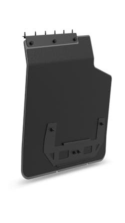

The AVAIL III+ Ballistic Door Panels
Angel Armor's AVAIL III+ provide patrol officers with the next level of protection as they are engineered to defend against NIJ Level III Rifle Threats with additional protection against special threats.
Although the AVAIL III+ comes with added protection for patrol officers it remains true to the AVAIL series by remaining durable and simple to install.
Specs
AVAIL III+
  • NIJ STANDARD 0108.01 (LEVEL III)
  • 7.62x51mm NATO (M80) 150gr FMJ @ 2750 +/- 50 fps (~ 853 mps)
  • Special Threat Protection (LAPD Specification MTD 11-BDP01)
  • 7.62x39mm PS BALL (MSC) @ 2380 +/- 50 fps (~725 mps)
  • 5.56x45mm M193 @ 3200 +/- 30 fps (~975 mps)
  • 5.56x45mm M855 @ 3050 +/- 30 fps (~930 mps)
VEHICLES
Chevy Tahoe (2015-2020)
  • Weight: 48.5 lbs
  • Thickness: 0.33 in
  • Coverage Area: 4.26 ft²
  • Areal Density: 10.6 lbs/ft²
Ford Interceptor (All New 2020)
  • Weight: 47.7 lbs
  • Coverage Area: 4.25 ft²
Dodge Charger (2011-2020)
  • Weight: 37.6 lbs
  • Coverage Area: 3.46 ft²
Ford Interceptor (2016-2019)
  • Weight: 47.4 lbs
  • Coverage Area: 4.23 ft²
OPTIMIZED COVERAGE
  • Seamless, single-panel technology
  • Concealed design doesn’t interfere with internal door components
  • Powerful Protection
  • Precisely engineered to defend against NIJ Level III rifle threats with additional protection against special threats
  • Proprietary Ballistic Technology exceeds NIJ multi-round standards
  • Advanced Innovation
  • Proprietary one-piece design is durable, weatherproof and provides optimized coverage area
  • Reinforced hinge kit included to deliver maximum door support
  • Retention strap ensures flawless door functionality
