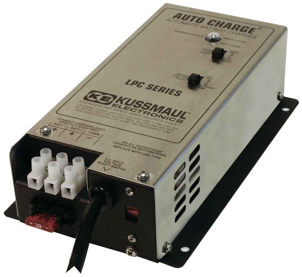

The Kussmaul Auto Charge 7 LPC 445-4290-5 is a 7 amp battery charger with a selector switch for 2 charging modes: float only or 3-step charging. The charger is light weight and has a low profile. The clean output poses no interference with radios and other mobile devices. The lead acid gel cell switch selects optimum charge/float voltages on battery type. This charger’s current limiting prevents damage from overload while the load activated cooling fan allows continuous operation at full-rated output. A heavy duty stainless steel case meets the rigors of emergency vehicle use.
Features
  • 7 Amps for charging vehicle batteries
  • Three step charging: bulk, absorption, float
  • Light weight, small low profile size
  • Clean output poses no interference with radios and other mobile devices
  • Gel cell/lead-acid switch selects optimum charge/float voltages based on battery type
  • Charger Status indicator light—changes color according to output
  • Current limiting prevents damage from overload
  • Load activated cooling fan allows continuous operation at full-rated output
  • Float / 3 Step selector switch protects batteries when charging under continuous load
  • Meets CE requirements
  • Designed for rigors of emergency vehicle use; heavy duty stainless steel case
Specifications
  • Input Voltage (Volts AC): 120/240
  • Input Current (Amp AC): 2.0/1.0
  • Input Frequency (Hz): 50/60 Hz
  • Output Voltage (Volts DC): 12
  • Output Current (Amps DC): 7
  • Battery Capacity (Amp-Hours): 14-70
  • Output Fuse (Recommended): 10 Amps
  • Protection: Input/Output Fuses, Current Limiting, Thermal Protection, Forced Air Cooling
  • Weight (lbs.): 4
  • Warranty: 3 Years
