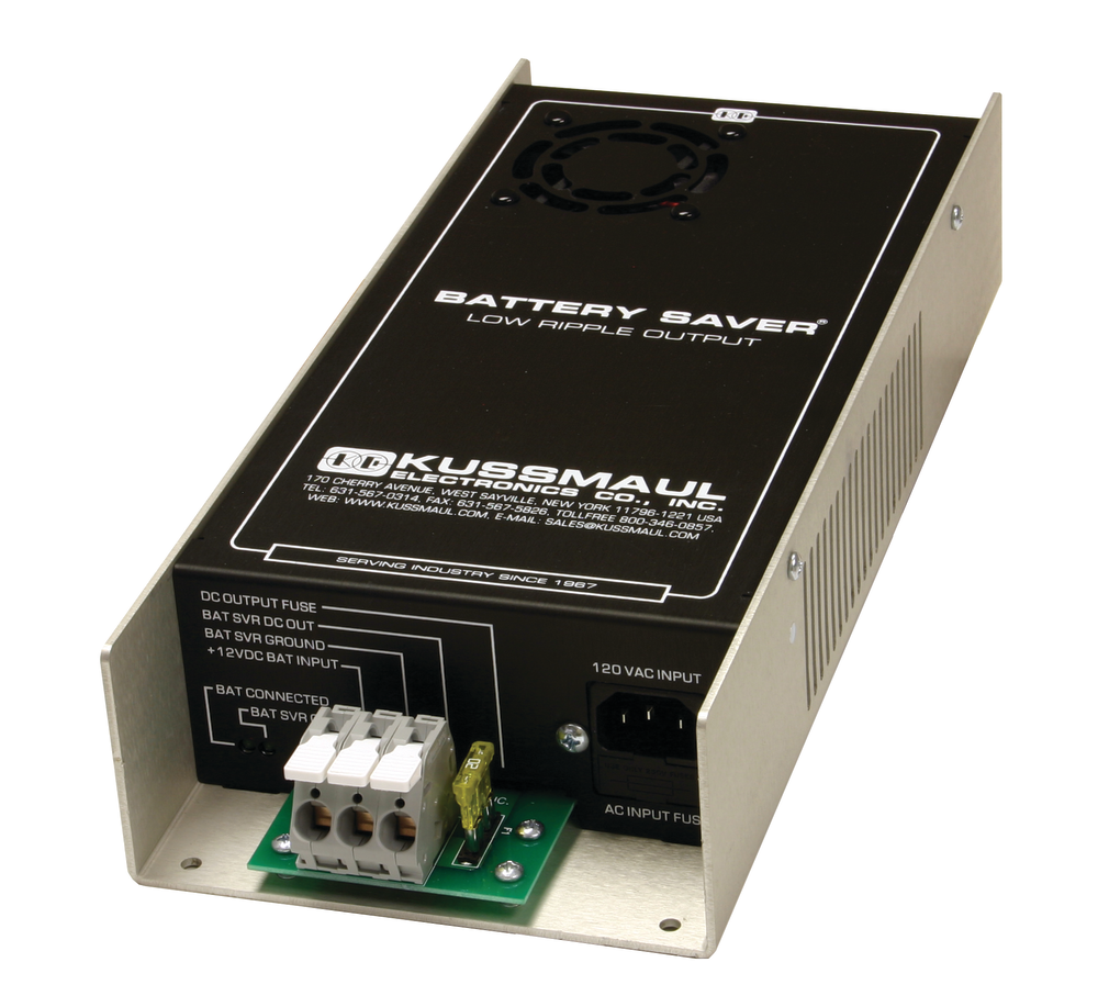

The Model 091-195-12, "BATTERY SAVER LOW RIPPLE HO," is a power supply with a load transfer relay. Inputs are the +12 volts from the vehicle's battery and 120 volts A.C. shore power. An MDT or computer may be connected to the output terminal. When shore power is applied a well-regulated switching power supply converts the 120 VAC to +12 VDC and a relay transfers the load from the battery to the power supply. This "BATTERY SAVER" provides low ripple D.C. power to ensure no interference while powering sensitive electronic equipment.
