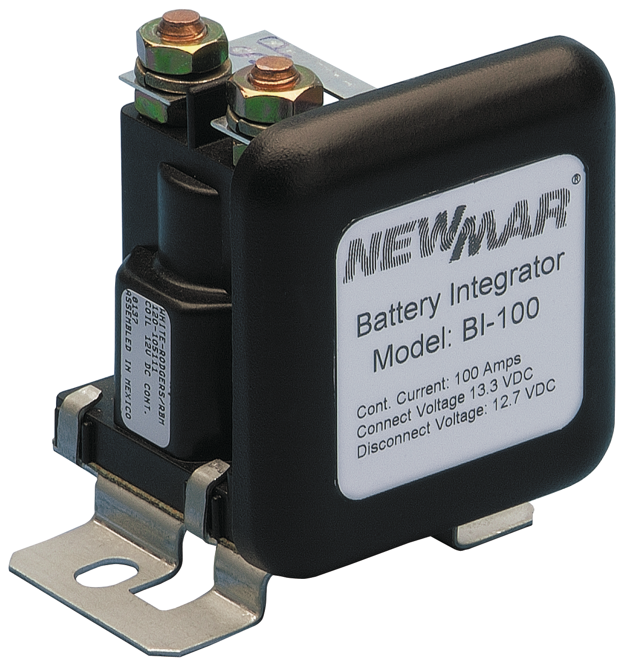

Battery Integrators
Charging multiple battery banks without use of diode isolators dictates that the batteries be connected or "integrated" only whenever a charge voltage is present so that they may be charged simultaneously, then disconnected or "isolated" when in use to allow for selective discharge and avoid having the secondary or standby battery drain into the primary battery. Battery Integrators perform this function automatically, acting as a "smart" switch to connect independent battery banks only when a charging voltage is present. Otherwise, they are isolated, and discharge between banks is prevented. The Battery Integrator causes no voltage drop in the charging system, while the multiple batteries are charged as a single bank whenever a charging source of approximately 13.2 VDC or 26.4 VDC or greater is present (depending on model). For more information, please visit http://www.newmarevpower.com/Battery_Isolator_Integrators/Battery_Isolator_Integrators.html
