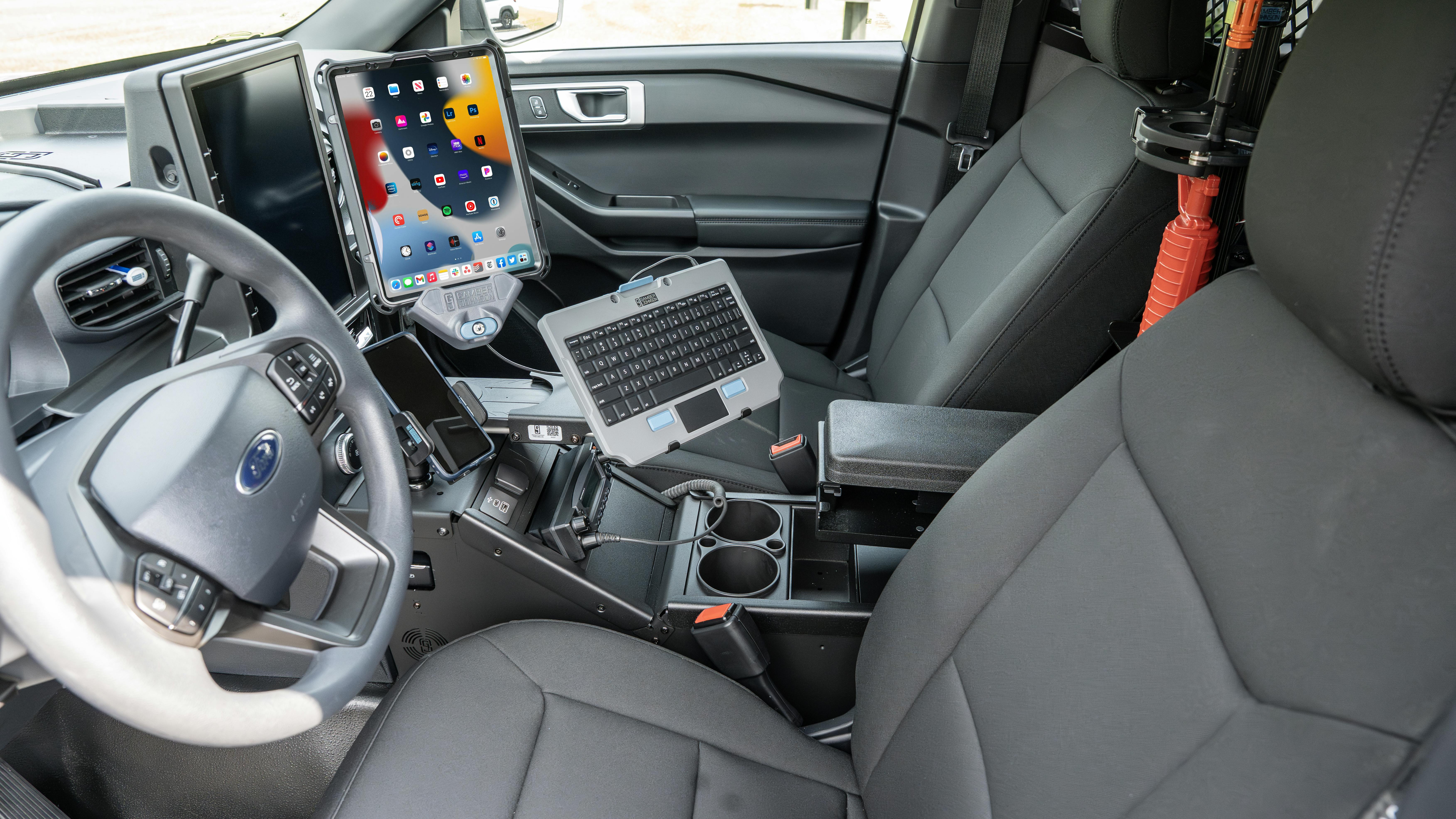

Securing equipment can be done in one of two basic ways: 1. We can anchor a mount to the vehicle’s floor, transmission hump, etc. and then lock equipment into the mount, or 2. We can put locking containers into the vehicle and then secure our equipment inside the lock boxes. The challenge most often seen with the second approach is that lock-boxes are used but not anchored. If we put smaller items into a bigger box but then don’t secure the box to keep it from moving, all we’ve accomplished is to create a larger and heavier projectile if there’s an accident.
Let’s consider the driver/passenger compartment first. For law enforcement, we have several necessary pieces of equipment, although the number is smaller than it used to be. What was common to see within the driver’s reach? A radio, a laptop computer, lights and siren controls, sometimes a second radio (county versus city), a scanner, and a mount for a shotgun or rifle. More often than not, all of that was mounted in a rack that was centered between the front seats, with the laptop computer mounted on a swingarm above the center rack and the long gun mounted either behind the driver’s right arm on or up against the partition separating the front seat area from the back, or on the floor on the passenger side of the transmission hump — a location that we quickly learned interfered with the placement of the laptop mount.
One thing that seems to be sometimes ignored is the necessary clearance for airbag deployment. Let’s not forget that a deploying airbag creates quite a bit of energy and, if everything isn’t installed and secured properly, the “popping” airbag can push/throw objects around the interior, and sometimes directly at the driver.
With an ever-increasing number of SUVs being used for patrol and far fewer sedans, designs changed. With the advent of computer-controlled lights and sirens, and more communications coming through the computer instead of a radio, there is less crammed into the center space in the front seat and therefore fewer potential projectiles. Still, there are other items such as e-citation handhelds, printers, flashlights, individual first aid kits (wouldn’t it be ironic if an IFAK caused an injury as it bounced around at high velocity inside the passenger compartment?) and more. Extra handcuffs are hung on searchlight handles; gear bags holding lunch or dinner, extra magazines, pens, etc. are almost always open, rarely secured to the passenger seat, and the all-too-common metal water bottle is shoved someplace where it won’t move… until you’re in an accident at 50-plus mph.
