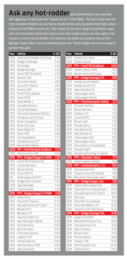

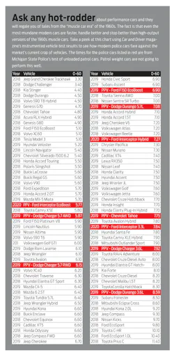

Modern cars available to the public are faster than they have ever been in the history of the automobile. Even a lowly minivan like the Honda Odyssey has a 0-60 time of around 6.6 seconds. Ford’s largest SUV, the Expedition with an EcoBoost 3.5L V6, clicks off a 0-60 time of 5.7 seconds, faster than an All-Wheel Drive Dodge Charger with Hemi 5.7L V8. The reality is that modern police vehicle performance lags behind some of the most popular sedans and trucks available to the general public. The danger lies in the fact that the more time and distance required to match a violator’s speed, the longer an officer has to over-drive their car’s capability and their driving skillset.
The single most important factor should not be what a car’s top speed is, but rather on how much time a vehicle spends at 90 mph and above doing routine patrol work. If an officer crashes at 90 mph they have a high probability of being killed. Crashing at 100, 130 or even 150 mph just determines whether the funeral is open or closed casket. Therefore, if we look at 90 mph as the threshold for fatality, then it is imperative to find ways to reduce the amount of time a patrol officer must spend above 90 mph during routine patrol work.
Another important metric that needs to be considered is horsepower to weight ratios. While marketing a car with 365 horsepower sounds great, the reality is that if that car weighs 5,200 pounds it requires all of that horsepower just to provide below-average performance. Thus a change in focus from raw horsepower to power to weight ratios can provide a much better insight into vehicle performance.
