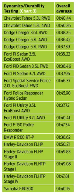

The Dodge Charger 5.7L AWD and Dodge Charger 5.7L RWD tied for the top speed of 150 mph while the Yamaha FJR1300 had the top speed of 143 mph in the motorcycle category [see Chart 2]. The Ford Police Interceptor Sedan retained its title for the sixth straight year as the overall quickest police vehicle tested from 0-60 mph. These are just a few of the many results—to view all of MSP’s collected data, visit its website at www.michigan.gov/msp.

McCarthy notes that in his 10 years working on the MSP vehicle testing, safety is something that is continuously being improved. “If you go back and look at the history of the vehicle testing, as far as braking effort went, the worst car today brakes better than the best car 10 years ago,” he says. “So the braking has become greatly enhanced. We have much better braking, because everyone saw that it needed to be improved. When police are given fast speeds they have to be given good braking so the cars aren’t a danger to be driven.” [see preliminary brake testing results in Chart 1]
