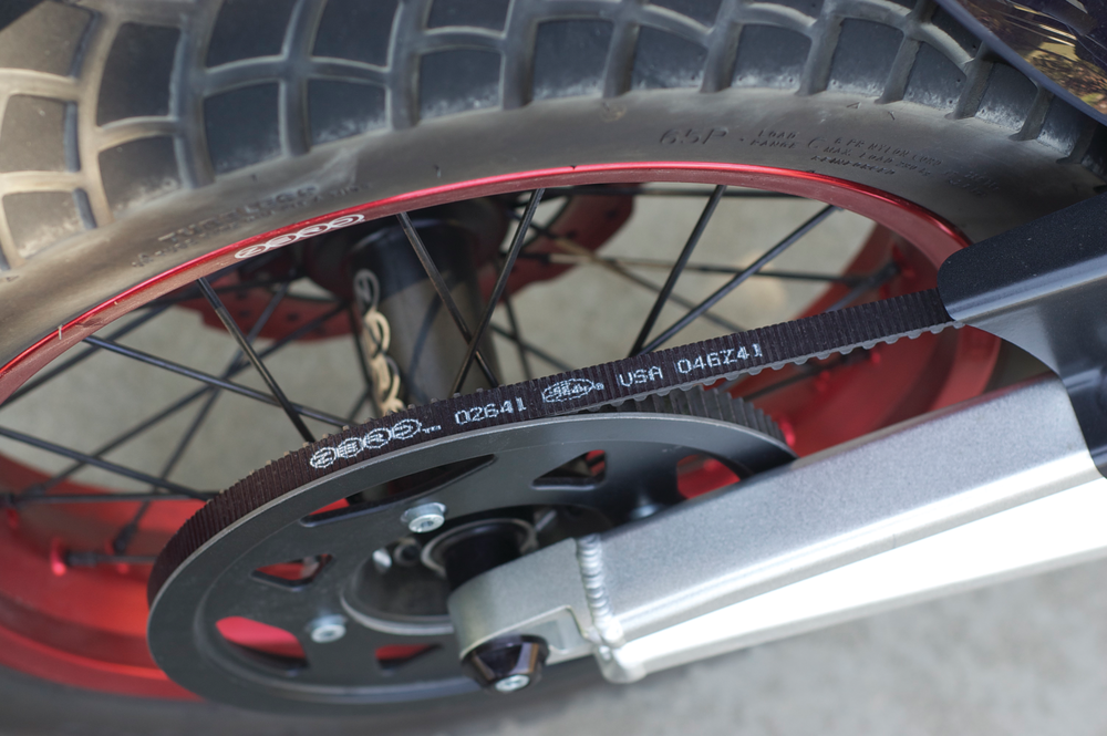

The Zero DS has a dual sport suspension, HB Performance single front and rear disc brakes with steel braided lines. The standard parts would be custom or premium aftermarket parts on most other bikes. The lightweight anodized 17-inch wheels and belt drive give the bike a unique appearance and handling characteristics.
