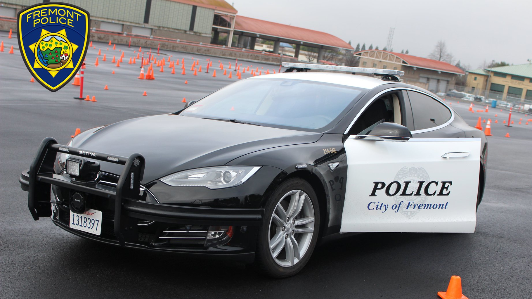

Over a five-year period, the used 2014 Tesla Model S will cost Fremont about $132,758 to own and operate, about $17,000 more expensive than a typical Ford Utility Interceptor would, police calculated in their report.
The Model S purchase price of about $61,000 was significantly higher than a roughly $40,000 police-ready Ford, and the Tesla required custom modifications that racked up to nearly $7,000 over what it would cost to outfit a Ford for police use, police said.
"There was no playbook," for how to get a Tesla ready for police use, Capt. Sean Washington said.
The brand new 2020 Model Y was purchased for about $57,000, police said, and modifications are still being made.
The used Tesla also had to be tested before use on the street, and Washington said in an interview the Model S went through some extra tires while being put through its paces at the Alameda County Sheriff's Office test course, which added to its startup costs, though some of those could be eliminated in the future.
However, the Tesla outperformed the Ford in some annual metrics during the pilot program, which helped even out the costs.
Police said the cost to charge the Tesla was about a fifth of the cost of fueling a patrol vehicle annually, and it was off the road 27 fewer days than the Fords were for maintenance.
