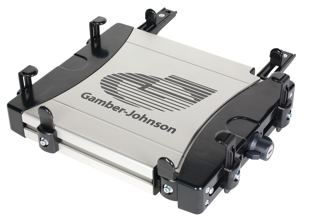

NotePad V Universal Computer Cradle
Gamber-Johnson, an ISO 9001:2008 certified manufacturer of rugged docking stations and vehicle mounting solutions announces the release of a new Universal Computer Cradle, the NotePad V — a rugged mounting cradle for most computers  in the marketplace today. The NotePad V is the next version of universal computer cradles. The NotePad V Universal Computer offers these features:
  • Special “flanged” side clips provide for superior strength – computers cannot be removed by bending the side clip.
  • Heavy duty keyed lock securely closes chassis when activated.
  • Computer is supported on all sides by strengthened clip design.
  • T-molded polycarbonate covers hold clips in place during installation for easy height adjustment.
  • Reversible front and back supports adjust to accommodate narrower computers and net books.
  • Sliding mounting plates on the underside of the cradle make mounting easy and allow for multiple offset options in the vehicle.
  • All restraints are adjusted by using one tool.
  • The chassis surface provides a level clamping surface for the computer and prevents it from rocking in the cradle and keeps it in place even on the roughest terrain.
  • Gusseted rear support brackets allow for added restraint.
  • No catch points, no pinch points and no sharp corners
  • Tested and passed MIL STD 810G, Method 514.6, Category 24 for one hour in each axis
  • Lock and slide mechanism is cycle tested for 10,000 cycles
  • Federal Motor Vehicle Safety Standard (FMVSS) 30 MPH front and side impact tested and passed.
  •  One-handed operation for inserting and removing the computer from the cradle.
  • Measures 10.62 inches to 16.5 inches wide; 1.5 inches thick; and 9 inches to 12.38 inches deep.
