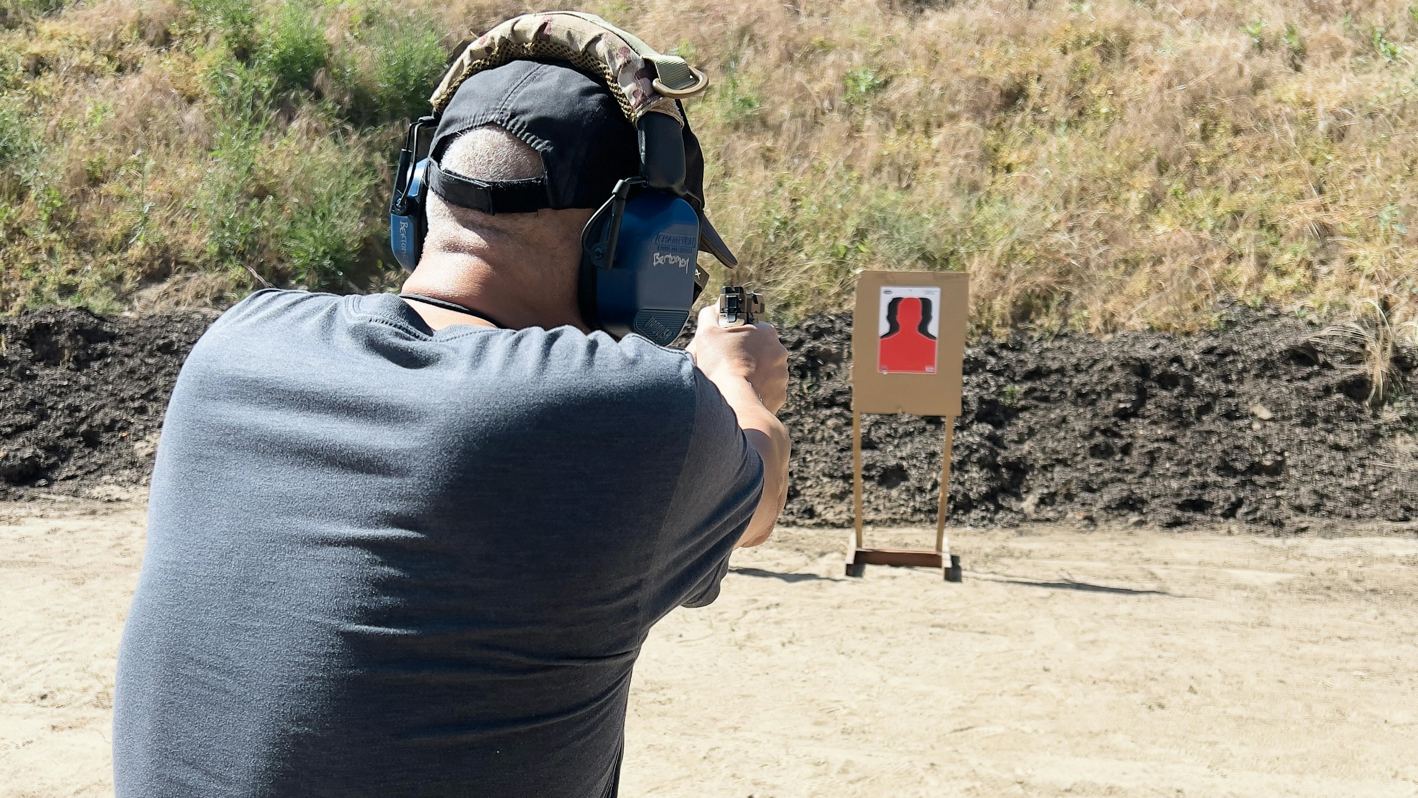

Simple qualification
The mechanics for this qualification is very simple. Using the qualification target typically used by the agency, outline a “T” that draws a border around the eyes and nose. This can be an imaginary outline, one drawn on the target, or using a preprinted target with a T.
The officer begins by facing away from the target on the 7-yard line with a holstered gun. On the command to engage, the Officer faces the target and delivers one shot into the T within 10 seconds. A qualifying shot must be fully inside, or touch, the T.
This qualification strategy has to be a task, among other tasks.
I would use a Birchwood Casey Dirty Bird Splattering Target for the qualification component. It has a hostage target that stands in front, and partially covers, two hostage taker targets, on the right and left side of the hostage. The hostage’s head covers half the face of each of the bad guys. Each hit creates a splatter pattern on the paper, which gives immediate feedback. Because there are two “bad guy” silhouettes per target, officers can have two attempts at qualification per target.
I like this target because it requires a precision shot to successfully neutralize the bad guys. The shooter has to fly the bullet into the exposed eye of the target. Hitting the forehead or the chin will not work.

Simple training
Hitting a T-Zone target is pretty straightforward, provided the target is facing the shooter. It gets a bit more complicated when the target is at an oblique angle. Although the qualification can be a simple, the training should be complex.
I use Birchwood Casey 3D Torso Targets. You have seen them before in (Dimension: Training With 3D Targets - www.officer.com/53068220). Set up several static targets, each facing at a different angle. From the 7-yard line, have officers fire headshots at the T. Allow officers to engage each target on the line. This will give each officer an opportunity to visually estimate the best shot placement for each angle.
Add variety to the scenario by placing a “no shoot” hostage in front of the headshot target. Create additional scenarios by adding a failure drill, where the shooter fires at center mass twice, assesses the target, then follows up with a headshot. If a failure drill is incorporated, require the shooting sequence to begin with verbal commands.
