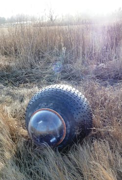

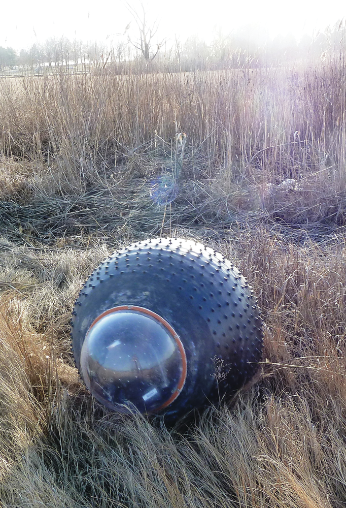

The GuardBot is an unmanned amphibious vehicle system that hosts cameras and other sensor suites to deliver advanced sensor communications in a mobile format. Robust and lightweight, it boasts impressive off-road performance and quiet maneuverability. Its cameras/sensors and mechanics are protected inside its sealed sphere. The electric vehicle can be operated by remote control, or programmed to navigate by GPS as a robotic mobile platform. Its Augmented Reality User Interface (ARUI) is highly intuitive, boosting operator alertness and control. Weighing 63 pounds, GuardBot has superb mobility and won’t get stuck in sand, mud or snow. It moves quietly and efficiently from land to water and back, at up to 6 mph (10 km/h) for more than eight hours.
