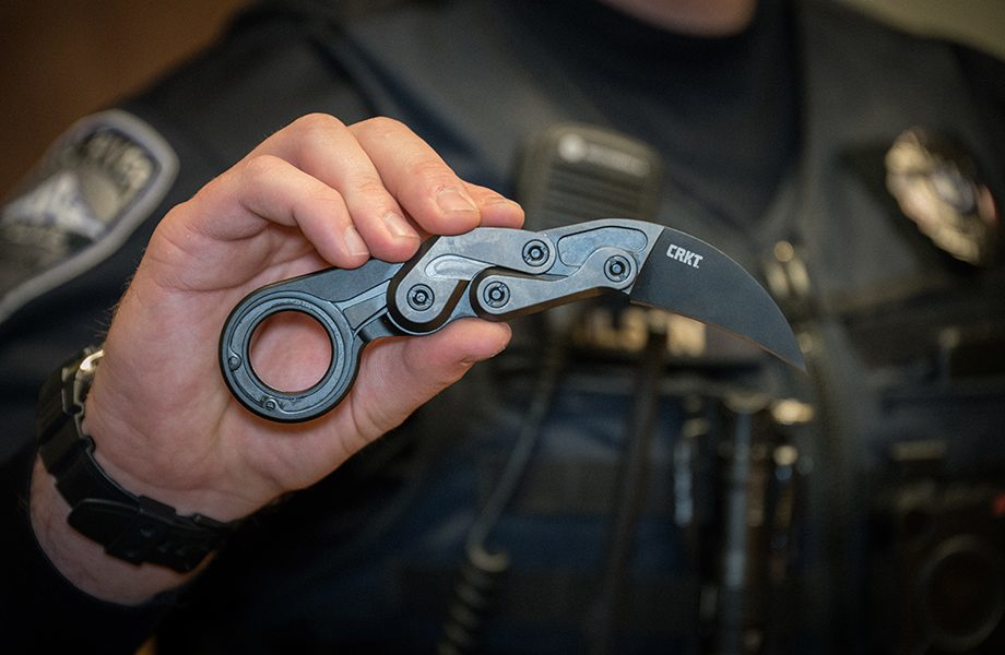

The CRKT Provoke
The Provoke (photo is primary for this article) I have has a safety orange main handle and black moving parts with a black coated blade. The Provoke is a folding karambit. For those of you unfamiliar with a karambit knife (as I was a few years back), think of a tiger’s claw with a handle on it. I’ve seen some edged weapons masters wield one of these knives with spins and hooks and the cutting blade can be truly devastating when used properly. For me however… “used properly” stops at I managed not to cut myself with it. There is a large ring at one end meant for your index finger. With your finger through the loop and the rest of the grip laying down through your palm, you wrap your fingers and the blade itself is pointing down and forward. It’s hooked (like a claw) and can do some devastating damage. The CRKT Provoke is a folding version of this (normally) fixed blade design and functioned flawlessly in all testing. It opens and closes smoothly, only when pushed to do so, and has a positive locking device to keep it open when you want it that way. The 2.5” blade has a plain edge and is 1/5th of an inch thick. Folded closed the knife measures just under 5” and it weighs just about ¼ pound. While the knife does have a super strong steel clip on the side, CRKT makes and sells a separate kydex type sheath for it. Understand that this knife is an excellent design and functioned flawlessly as designed. That said, I was trying to find a way to deploy it with my support hand, reversed in my hand from its intended deployment (so blade up and forward instead of down and forward) for use as a defensive weapon if attacked by multiple assailants trying to get my sidearm. I haven’t mastered it yet, but I continue to work on it. If you’re into the unique and different type of knife, this is for you. If you’re a “knife guy” and like to master movement with different types of blades then again – this is for you.  MSRP is just under $100 with another $30 for the sheath. CRKT’s website shows these knives as out of stock as this is written.
