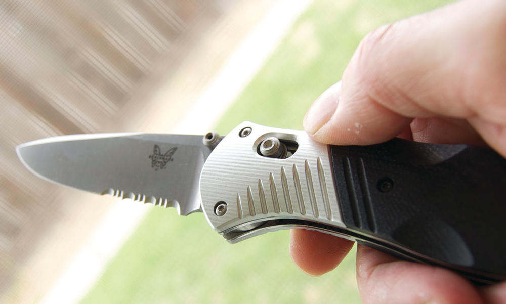

Benchmade 581S Barrage: knife sculpture for serious operators
The 581S Barrage was selected for this test because many officers want their knives to look like it belongs in a knife collection, and yet be cost effective enough to be a working knife. This is the knife. Even though this model is not “tactical black”, a close look will reveal that the blade has micro patterned lines almost perpendicular to the edge. It barely reflects light, giving it the look of a professional chef knife. Since I could slice a tomato hair thin with it, even after the edge wear test, the look is appropriate. This model comes with a black coated blade, but this is one good looking piece of steel.
The 581 Barrage uses the AXIS Assist locking mechanism, which is similar to the original AXIS Assist, except it has a spring assist. It features 3.60-inch M390 Super Steel drop point blade with a Rockwell hardness between 60-62. The most striking feature of this knife is the scales: G10 and aluminum with serrations that were eye-catching and useful.  It also has a full length metal liner, recessed torx screw assembly and two positions for the pocket clip. The knife fills the gap between “I just purchased a custom knife” and “It’s a working blade designed to take a beating.” It is absolutely ideal for a law enforcement gift that will get the officer out of a challenging situation without equipment failure, and look good doing it.
I have an original Benchmade 710 in ATS 34 with the BT2 coating, an original AXIS Lock model, the non spring assist version. I got it when it first came out and have cut my way out of many situations while in uniform over 20 years.
The AXIS Assist locking mechanism uses the same principle. A deadbolt-like bar falls in behind the recess in the blade when opened. This does exactly what we desire in a folding knife: The inherent strength is indistinguishable from a fixed blade. The AXIS Assist locking mechanism  adds a little extra to the mix. Because it is easy to polish the bearing surfaces of the lock, it is inherently the smoothest method to lock or unlock the knife. Users like myself have AXIS  knives that have been opened and closed thousands of times in really bad environments without any noticeable wear.
Closing an AXIS knife is smooth and safe. One does not have to put the fingers in the path of the blade to use it. I am not a fan of automatic blades. It only takes firing one in the pocket to explain my feelings about them. The AXIS Assist mechanism is as fast as an auto, except stronger and safer. One simply starts the blade in motion, about 20-30 degrees, to open. It has a safety in the spine, allowing the user to open and close the knife with minimal grip shifting.
M390 is a tool steel often used in manufacturing. Its properties are suited for various aspects of the plastics manufacturing industry. Its formulation is good for repeated cutting tasks at lower temperatures. “Lower temperatures” means it is not a high speed cutting steel, which resists the high temperatures caused by friction. M390 also has a high chromium content which aids in its corrosion resistance.
M390 is made by sintering, which means that it begins as a powder which is heated at a controlled rate. This fuses the molecules and resists clumping of compounds, creating a more homogenous, fatigue resistant steel. M390 will accept a high polish and sharpens to a consistent and lasting edge. Bohler, the supplier of this steel, calls it M390 Microclean, based on its wear and corrosion resistance and likely its ability to accept a high polish. This polish, by the way, adds to the perceived sharpness of the Benchmade 581 Barrage. Benchmade calls M390 a Supersteel. And it really is.
The Benchmade 581 Barrage can do all of the cool tricks that a really sharp edge can do, like slice paper and shave the hair on one’s arm. More realistically, I found the hardness of the steel required a diamond stone to sharpen, unless I wished to sit there a while.
Besides getting “Oohs and Aaas” from other officers, the 581 Barrage performed exactly as advertised. Most testers use a guide, which consistently positions the blade when doing the manila rope test. This positions the cutting edge consistently, but this does not simulate “patrol like” conditions.  I used a board and a kevlar patrol glove to hold the handle.
The 581 Barrage drop point blade is great for general duty, especially for varied applications. The tip can be inserted into some of the folds of a brick the officer found in the door panel or wheel well, or used to pry a sheetrock panel off a wall. I prefer a bigger recurve like the Bowie style in the SOG for cutting rope and wire, however. It puts more blade down on the problem.
I found the Benchmade 581 Barrage excelled in cutting rope because it filled the hand. The front serrations and the contours of the scales, combined with the extra thickness of the grip reduced the fatigue of this kind of cutting. Believe me, I had to take breaks every 15 minutes or so. I was thankful for the raw cutting power one can generate with this blade. Benchmade has signature edge serrations, which add to the excellent cutting ability, even when slicing wire.
