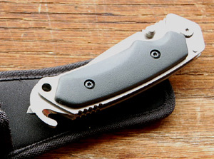

That brings me to the HawkHook from BLACKHAWK! With a 2.25" "blade" and measuring only 5.5" overall when opened, the HawkHook is amazingly versatile for a single-blade small tool. The blade is manufactured from AUS8A stainless steel and finished in a matte bead-blast non-reflective fashion. Incorporated into this single-blade tool are:
  • A glass breaker
  • A flat screwdriver / pry tip
  • A seat belt / nylon webbing / cord cutter
  • A bottle opener (THAT's a cool "church key")
  • A serrated cutting edge (for rope)
  • A wire stripper
SIX tools in one compact package. The ambidextrous thumb stud means you can open it with either hand, BUT (and this is my only potentially negative comment) the entire tool is so small that it isn't easy to open. The tolerances are so tight... It uses a liner lock to secure the blade open and has textured nylon scales as grip panels. Given the size and single blade design, the amount you can do with it is quite impressive.
