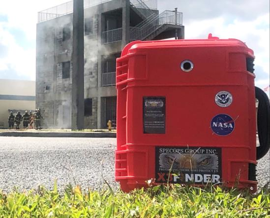

The X3Finder system assists search and rescue teams, firefighters and law enforcement. This tool is self-contained, man-portable and operates in most weather conditions. The system has minimal setup time and is ready to scan in approximately sixty seconds. Scan results are displayed in minutes. SpecOps Group's instant-on system keeps the first responder at a constant state of readiness.

The system's sensors are encased in an impact and IP67-rated case for all weather conditions. X3Finder is man-portable and designed specifically to fit in any overhead compartment for air travel. SpecOps innovations are driven and developed by first responders for first responders.
